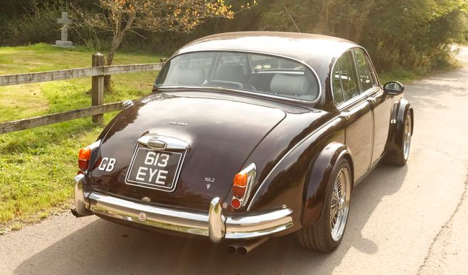

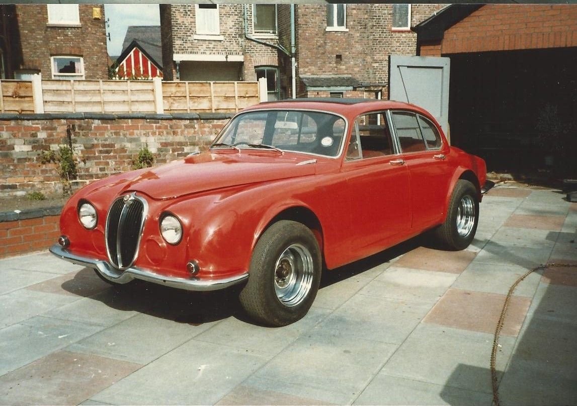

Old Sep 30, 2024 | 11:01 AM
Peter3442's Avatar
Joined: Aug 2020
Posts: 2,293
Likes: 1,463
From: Oxford, UK
This is an option that I didn't mention.
I'll now wait for the explosion ... !!
Old Sep 30, 2024 | 11:27 AM
Cass3958's Avatar
Joined: Feb 2019
Posts: 1,599
Likes: 1,224
From: Torquay Devon England
BOOOOOOOOOOOOOOOOOM !!!!!!!!!!!!!!!!!!!!!!!!!!!
Similar thing done to an S Type with the same result. Disaster in my humble opinion.
Old Sep 30, 2024 | 04:19 PM
jerry_hoback's Avatar
Joined: May 2007
Posts: 3,489
Likes: 1,265
From: Indiana
While I Always try to respect other peoples cars, those 2 are grotesque!
