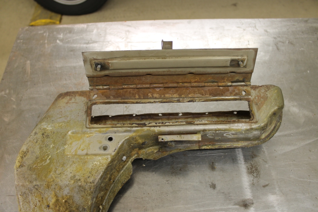

Here's the hinge location - I don't recommend this approach for access.

Hey Doug,
Just what I am looking for! Mine is very rusty. Is it for sale, or are you using it? I am speaking about the entire plenum.
Lin
Ahhhh....mystery solved!
Thanks, Doug.

Jose's Avatar
Posts: 9,139
Likes: 2,662
wow, that's the mother of all plenums-scuttle vent assemblies! Now I understand...
