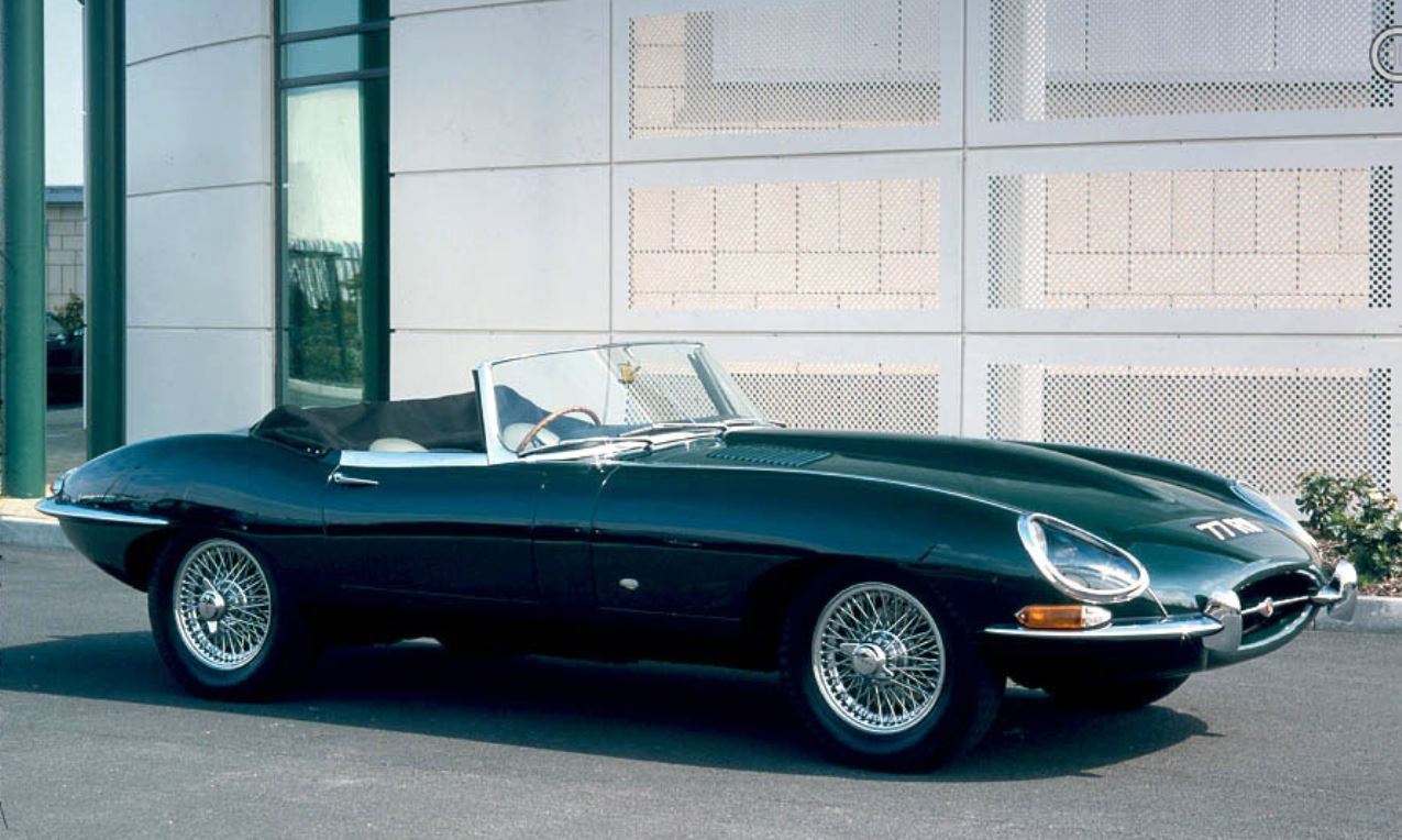

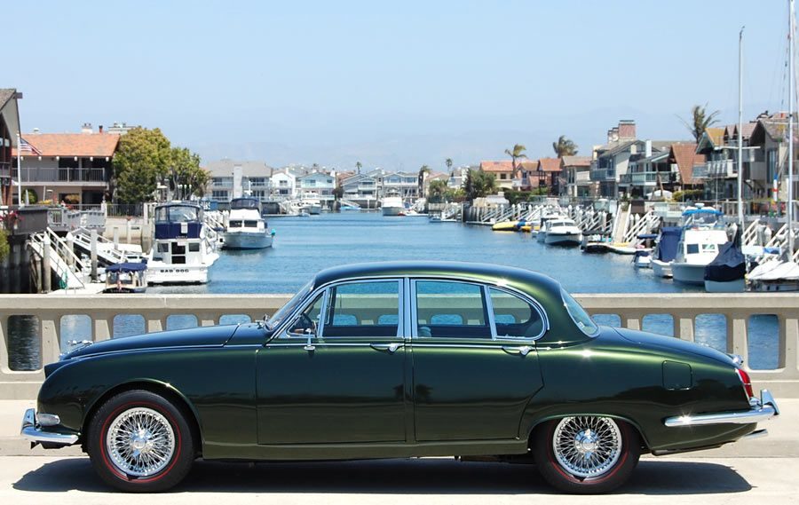

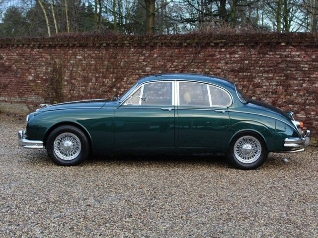

S Type:
Stubby tail Mk2:
E Type:
Roadster:

The S-type (S series) tends to look best in darker colors (colours) which effectively mask the line of the trailing edge of the rear doors, which was a cost saving hold-over from the "stubby tail Mk-2". Glyn's is an exceptionally attractive example. IMHO.
