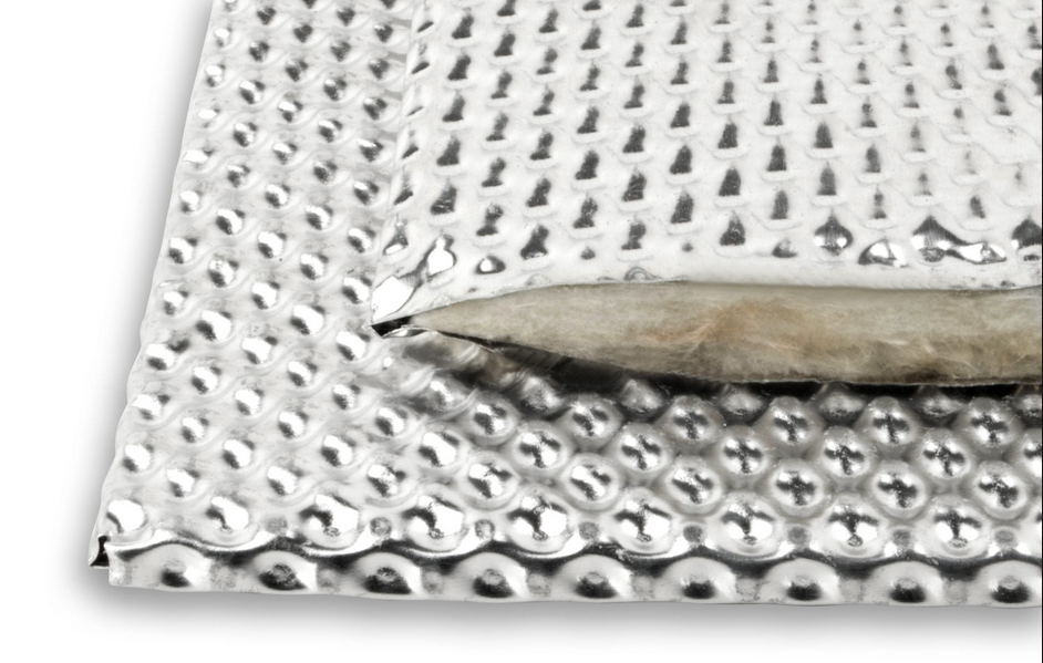

Try putting some heat shielding between the exhausts & your fancy stainless steel tank. You could be building up vapour pressure above the liquid fuel.
I would still start with a gravity feed direct to the carbs as discussed in your other thread on this issue. Otherwise you are going to keep chasing your tail.
