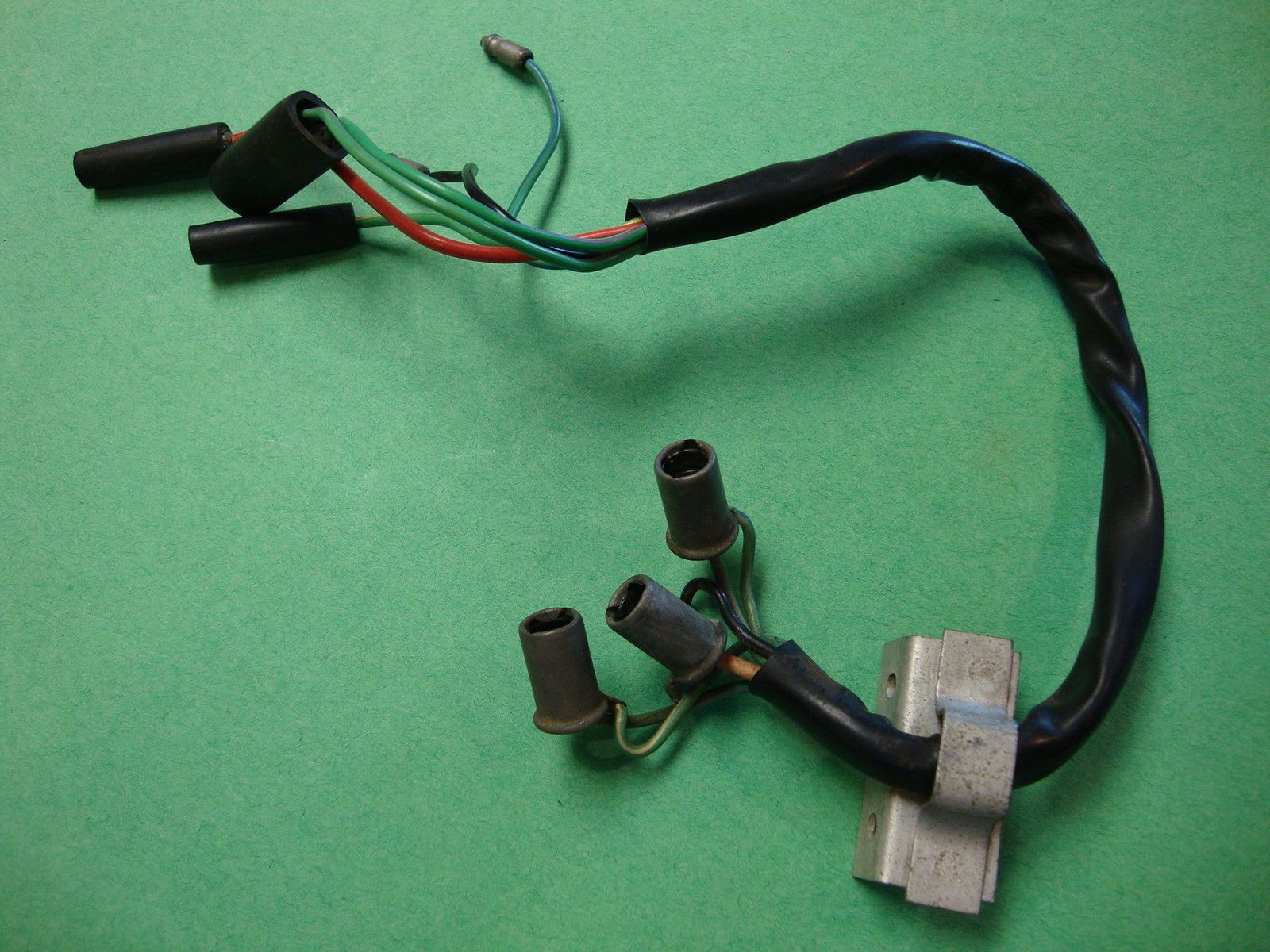

All I can do for you is. The color coded wiring diagram is high res. Suggest you blow it up & have it laminated. Stick it on your garage wall as I have done. I re-harnessed my entire car when restoring & found it a huge help.
Column Wiring harness:

you must have disturbed the black wires (Ground).
shouldn't be difficult to find. Get a bright light and light up the top of the steering column where those wires meet. The black wires meet at a 4-point connector with a rubber sleeve.

That is what I am imagining, that I pulled too hard or wedged a hamfist too far.... Ill check there. Thanks.
