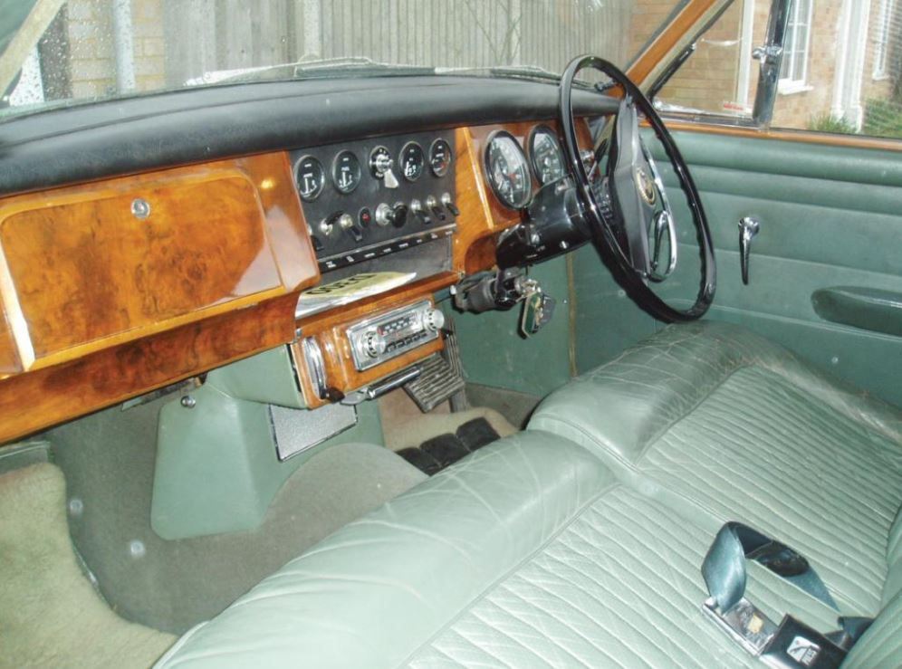

Hi Forum members.

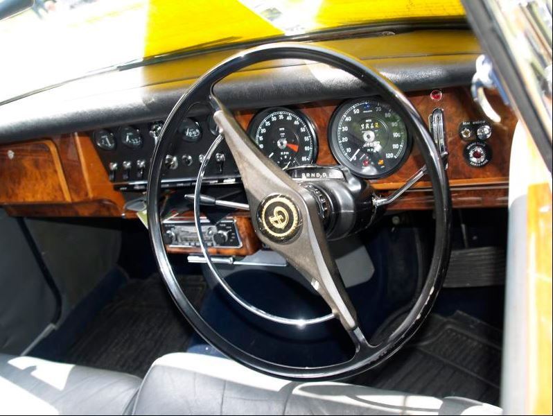

Did our cars come from the factory with gloss finish to the wood work especially the dash and panel above the dash? My car is a1964 Daimler 250 V8.
Replies appreciated.
David B.
Old Apr 11, 2021 | 04:03 AM
Cass3958's Avatar
Joined: Feb 2019
Posts: 1,599
Likes: 1,224
From: Torquay Devon England
As far as I am aware and looking at all the promotional photos in my collection of S Type brochures all the wood had a gloss lacquer finish.As the Daimler was an upmarket Mk2 I would assume the wood finish would have been like glass.
Even if it was not supposed to be gloss a glass like finish looks superb and cannot be beaten.

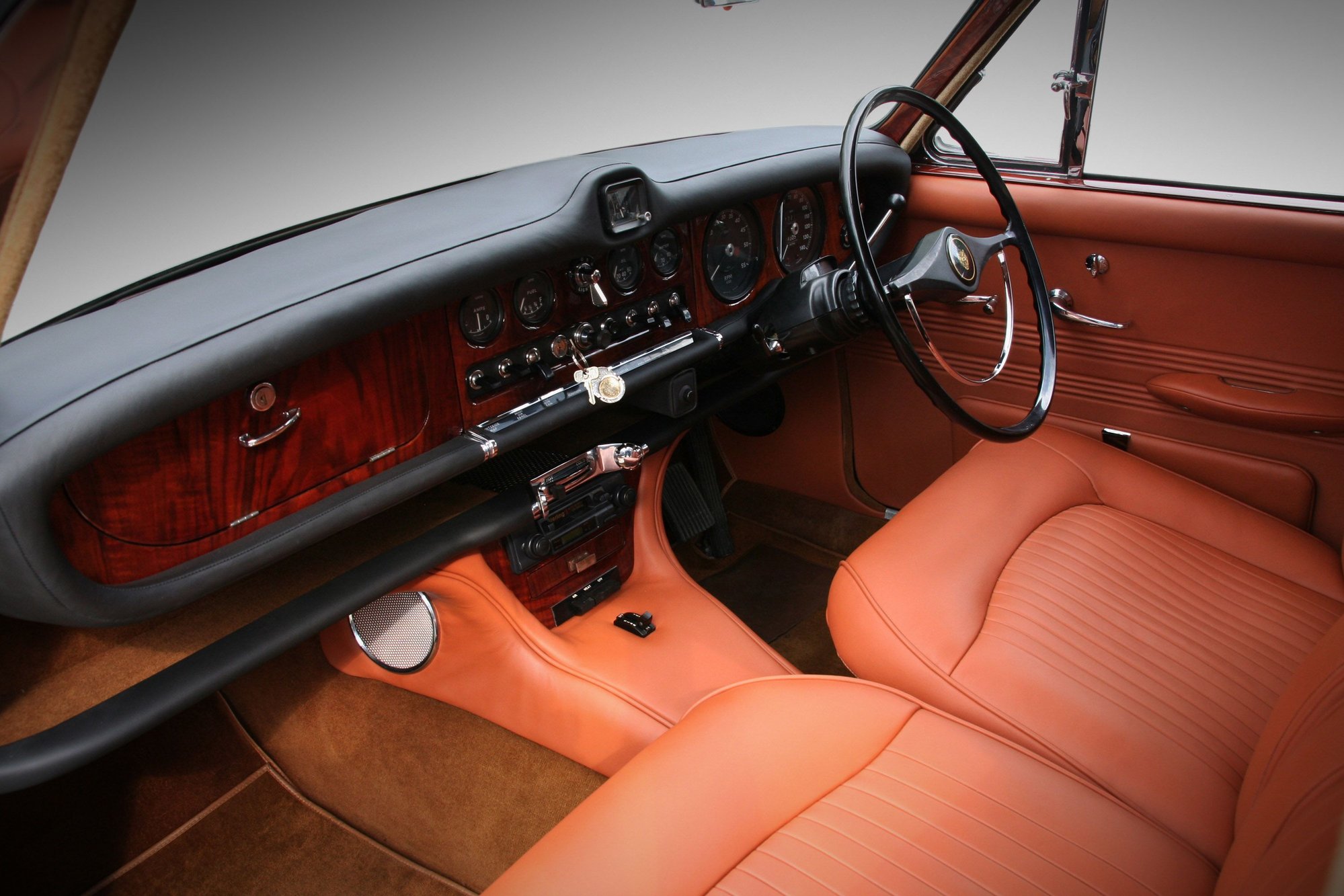

Old Apr 11, 2021 | 10:25 AM
Glyn M Ruck's Avatar
Posts: 5,546
Likes: 1,495
Gloss it is & certainly for your year. We probably sometimes overdo it but it's nice!
Some of the final Daimler V8 250's dashboard tops were padded and upholstered in black Rexine,

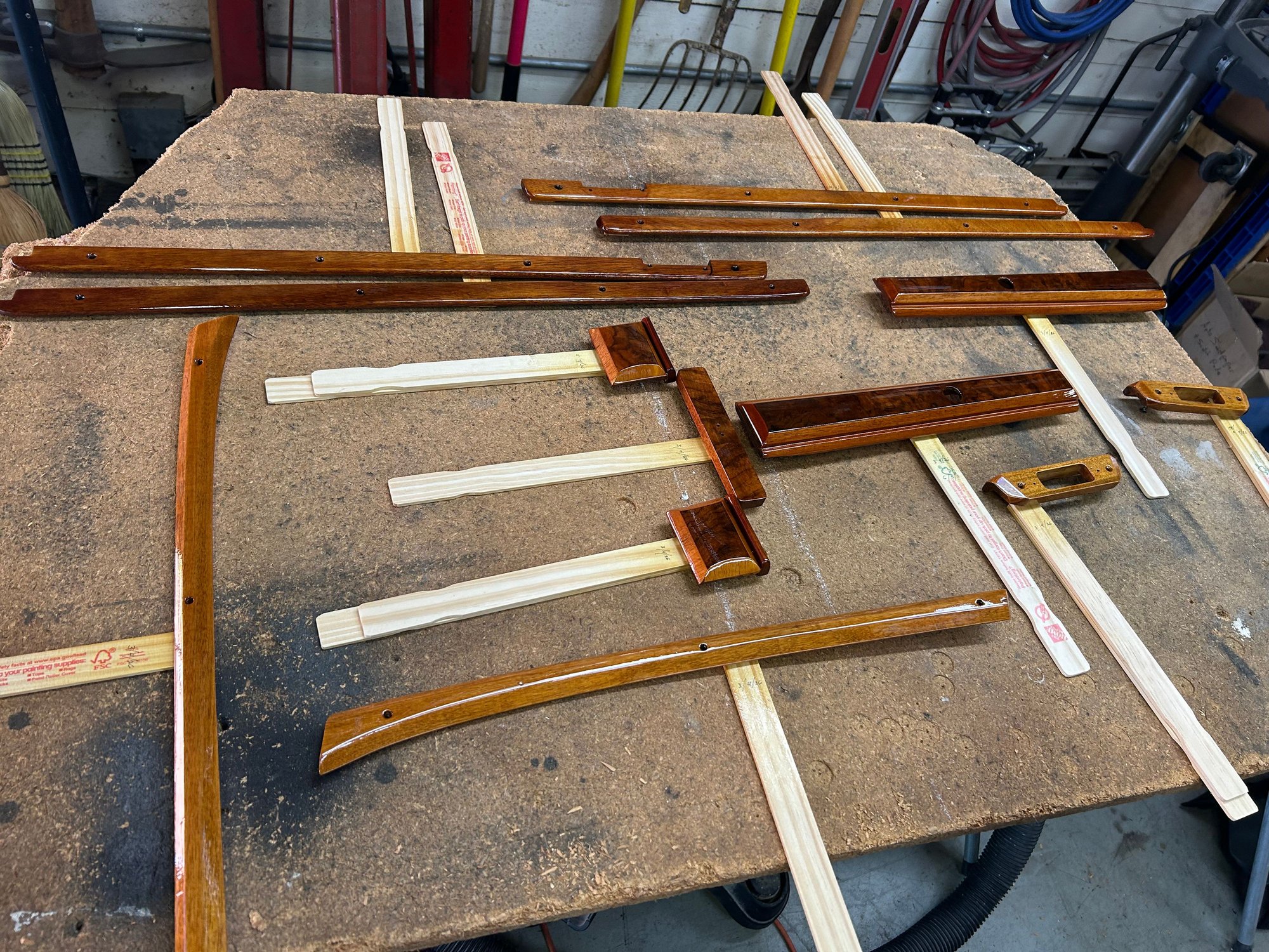

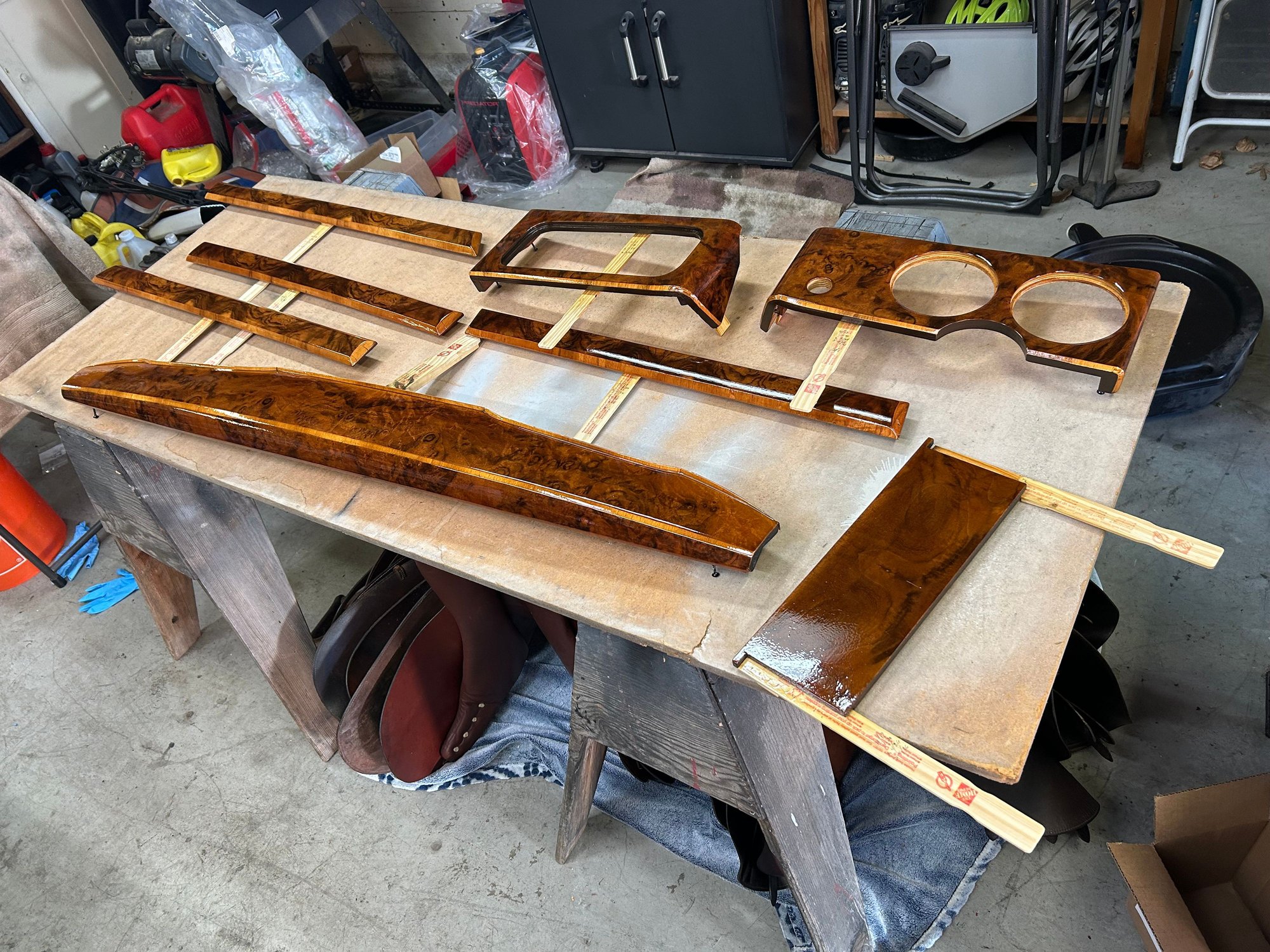

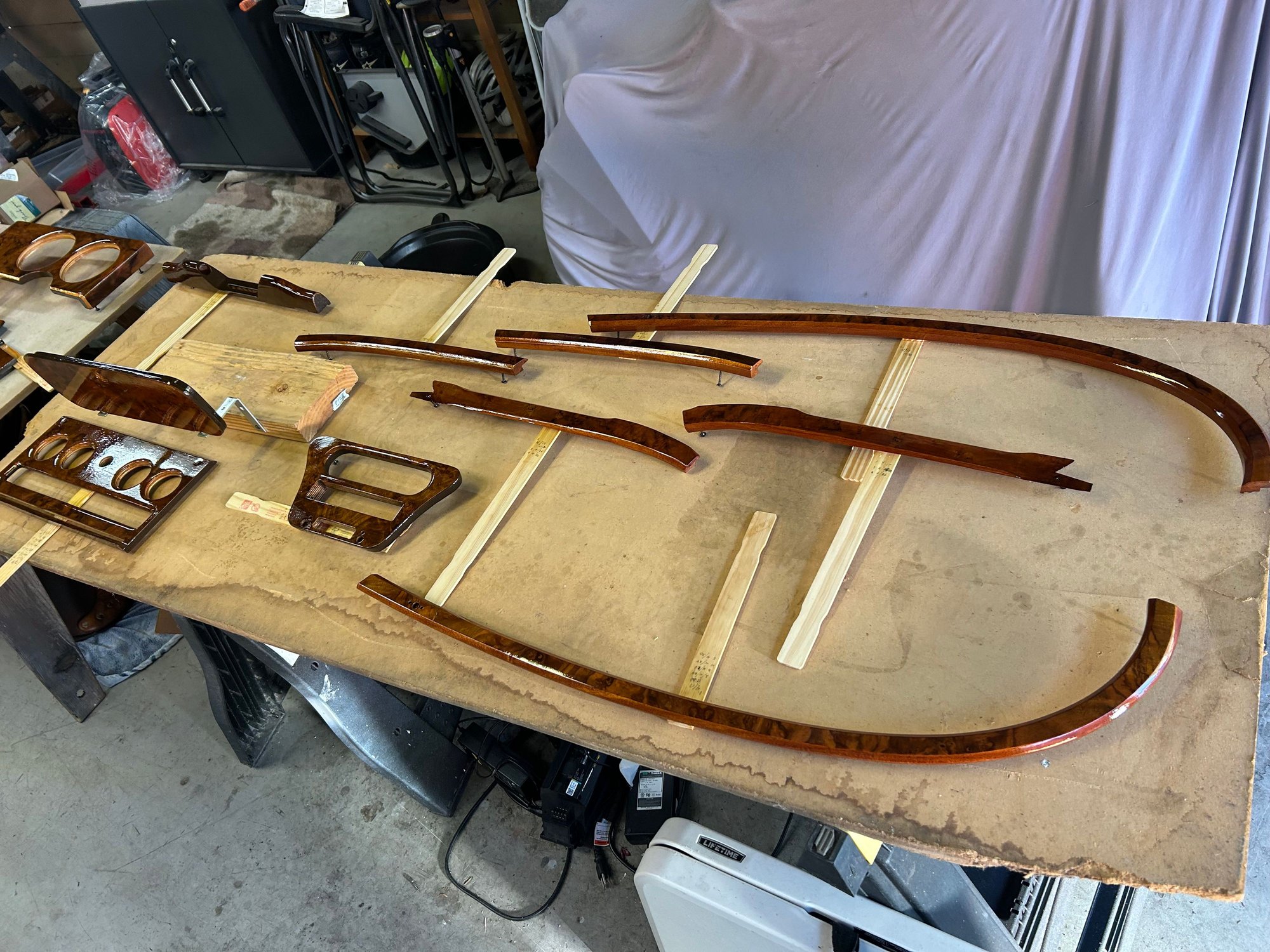

Old Jun 5, 2025 | 09:32 AM
Felixbobcat's Avatar
Joined: Sep 2022
Posts: 168
Likes: 93
From: Los Angeles CA
Thought I'd update on the work I've been doing on the wood. I went with the Epifanes Clear Gloss Varnish which is fairly easy to work with however takes a long time to dry. They say 24 hours before sanding and re-coat. I found it necessary to wait 48 hours here in southern California by the coast. I think the high humidity here over the last few months may have slowed down the drying process. I'm very happy with the results so far. If I had a spray booth they would not require further sanding and polish which I will need to remove dust particles in the final coat. I got a lot of great and generous advice from Saul Chaplin from British Auto Wood. I will be purchasing one of his shift knobs in payment for his help. He is a true gentleman!
Total of ten coats on all the wood except the dash and console parts that got twelve after block sanding to remove irregularities from the grain of the wood which can be seen in the above picture. The top door caps got same treatment since I wanted a little extra UV protection on them as well.
Now I have to let them cure for at least a month then sand and polish.
