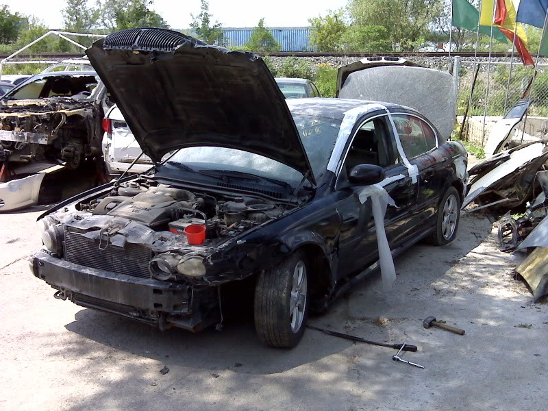

Thank you guys for a nice welcome, I totally understand everybody has their thing.... I respect that. I don't pick sides, I like to be neutral. I like all types of cars, but to be quite honest with you I choose the Jag X type as my project because i wanted to brake out from the pack of stereotypes.
Here she is, the day I've got her, don't worry she is on the road to resurrection:

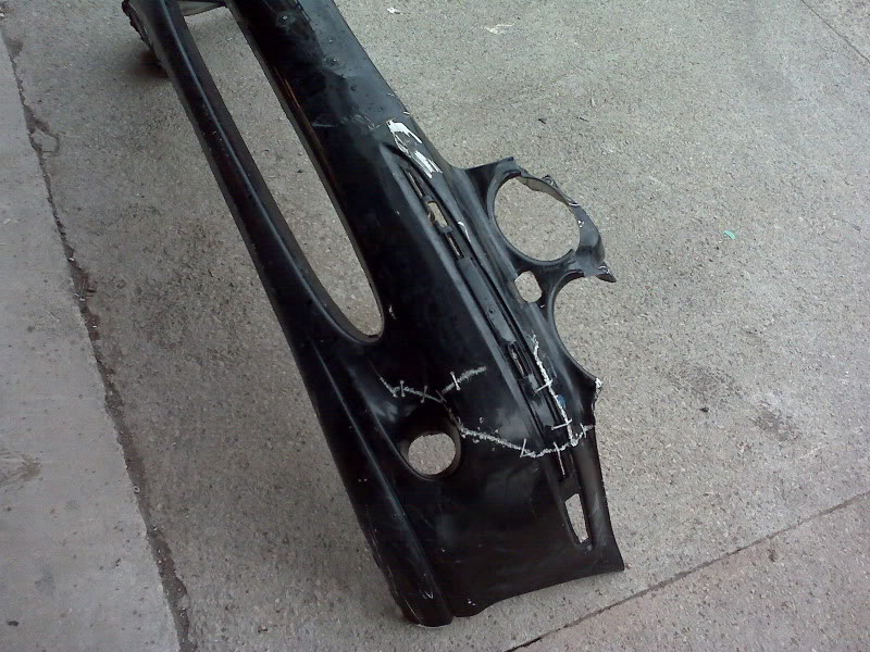

My first challenge was to tackle the bumper that was in pieces, I wanted to put it together because I didn't want to buy a new one and start cutting it to make it a bit custom/tastefully different.
so I drilled holes around the cracks, zipped tied it together to get the shape, pastic weld it, to make the crack stonger I put JB weld on the inside...
I know you guys might think I'm cheap and that I don't want to spend money on stuff, but money is not the issue here... I want to redo the bumper to still have the stock, sleek look but at the same time be a bit different. Its hard to explain what I want to do, but in my head I know it will look good. Something different then all the Arden Spoiler I see....Don't get me wrong they look amazing on X types, but I want to make this one my own.
