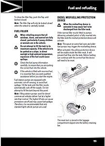

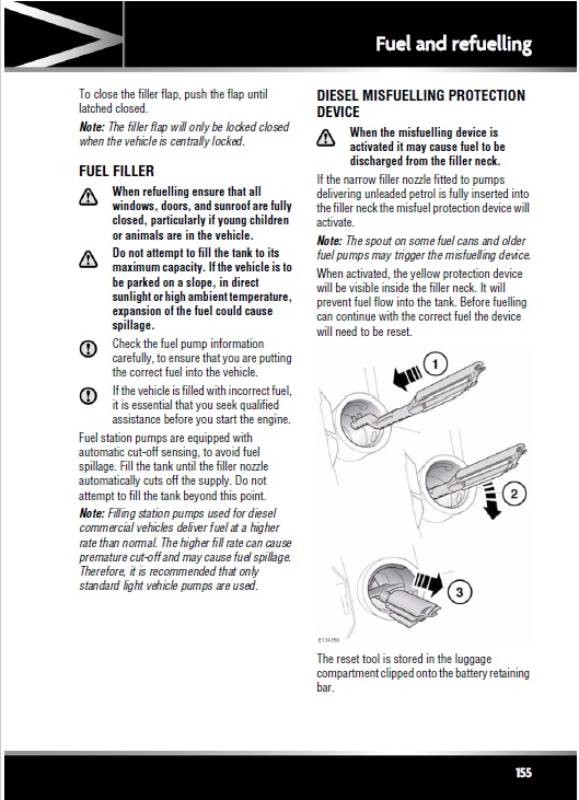

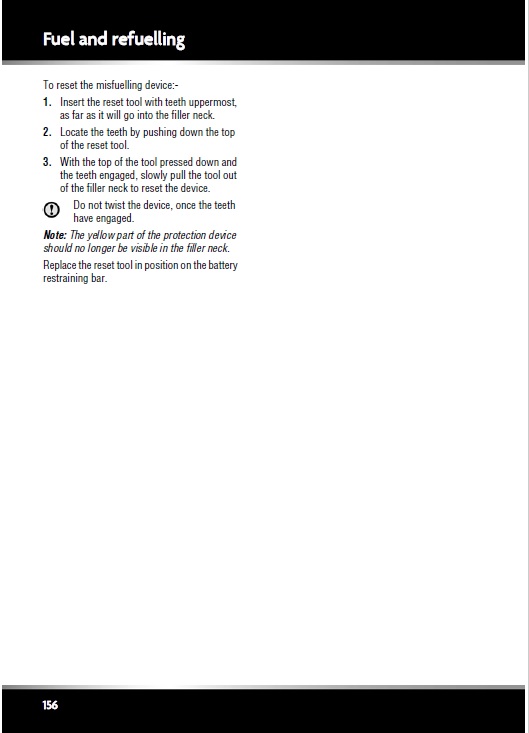

Hi, having just recently bought a used Jaguar XF privately I've found refuelling to take a long time. I just noticed the misfuel device to be in place, previous owner must have triggered? Unfortunately there isn't the tool in the car's tool kit to deactivate. Is there any other way of doing it or do I need to visit a main dealer?

We must stop meeting like this. The X250 forum is the place to post technical questions about your model.
Resetting the diesel misfuelling protection device is a DIY job:
(double click on the images to enlarge them)
The Part Number for the Fuel Nozzle Guide Reset Tool is C2Z8432. The easiest way to acquire one is from a Jaguar Dealer but aftermarket suppliers (e.g. JustJagsUK - £17.67 + VAT) may charge less.
