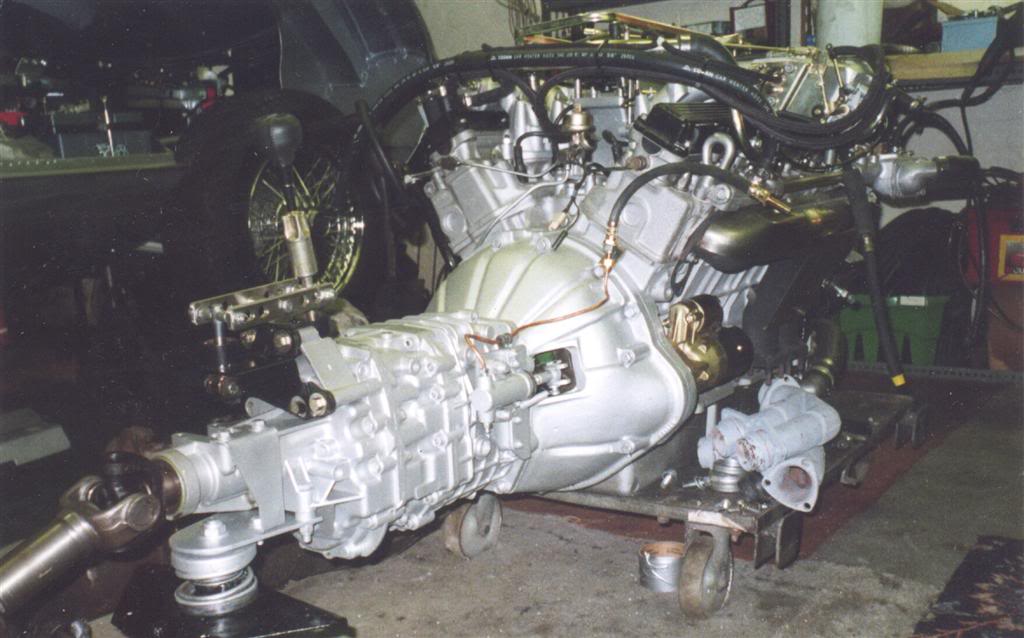

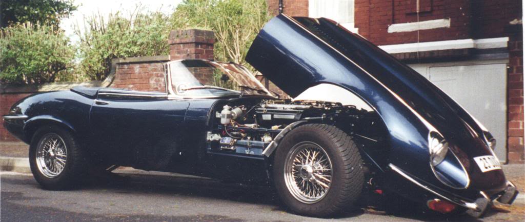

Maybe post in the XJS forum, this is the route I'd take, done 5.7/6.1/7.2lt conversions to E-Types with fuel injection and electronic engine management - a worthwhile job, even more so with manual trans.
Try and locate a late model 6lt XJS - and transplant the lot.

The XKE shown looks almost exactly as mine. My car is also dark blue. I'm way beyond swapping in a late engine. This will be a full built engine using everything I can to increase capacity as well as the efi using aftermarket management. That, or I may use Rick Pattons throttle body conversion using the Stromburg bodies. Good looking set up, looking very stock. I have gone through my 5.3, even installed the Tremec 5 speed, aluminum flywheel, and SS headers. And yet, a few weeks ago, got outrun by a Volvo turbo wagon, Seeing how the only difference between us and animals is our ability to accessorize, I gotta dress up my driveway jewelry even more, lol.

The one pictured is 5.7.
The silver car is 6.1, GTJ alloy flywheel, GTJ killer cams, Tec 3 managment, with modem for altering parameters on track, big valve heads, Pheonix headers, Getrag box, Quaife diff, alloy bonnet Dayton custom wheels, AP Racing calipers and racing discs - I'd like to see the Volvette out run that car! ;-)
The 7.2 is a full TWR unit - I have a spare but it's big money, forged crank and steel mains. Oh, and a full set of Omega pistons along with GTP magnesium throttle bodies. 750bhp no problem.
I didn't know to what extent you want a tune - it's about how much money you want to spend, I have a friend called Rob Beere, maybe have a chat with him about V12'S.
Rob Beere Racing: Performance Jaguar Parts
It's all been done before here in England - like I said, how much do you want to win a pissing contest! ;-)
