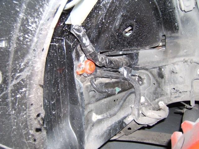

Posted a number of times but yes.
Under the passenger side wheel liner is a power post.
This is a Lincoln LS but same car in this area.
Attached Thumbnails 04 STR Battery Completely Dead - Can't Get to It-front-wheel-well-battery-post.jpg
