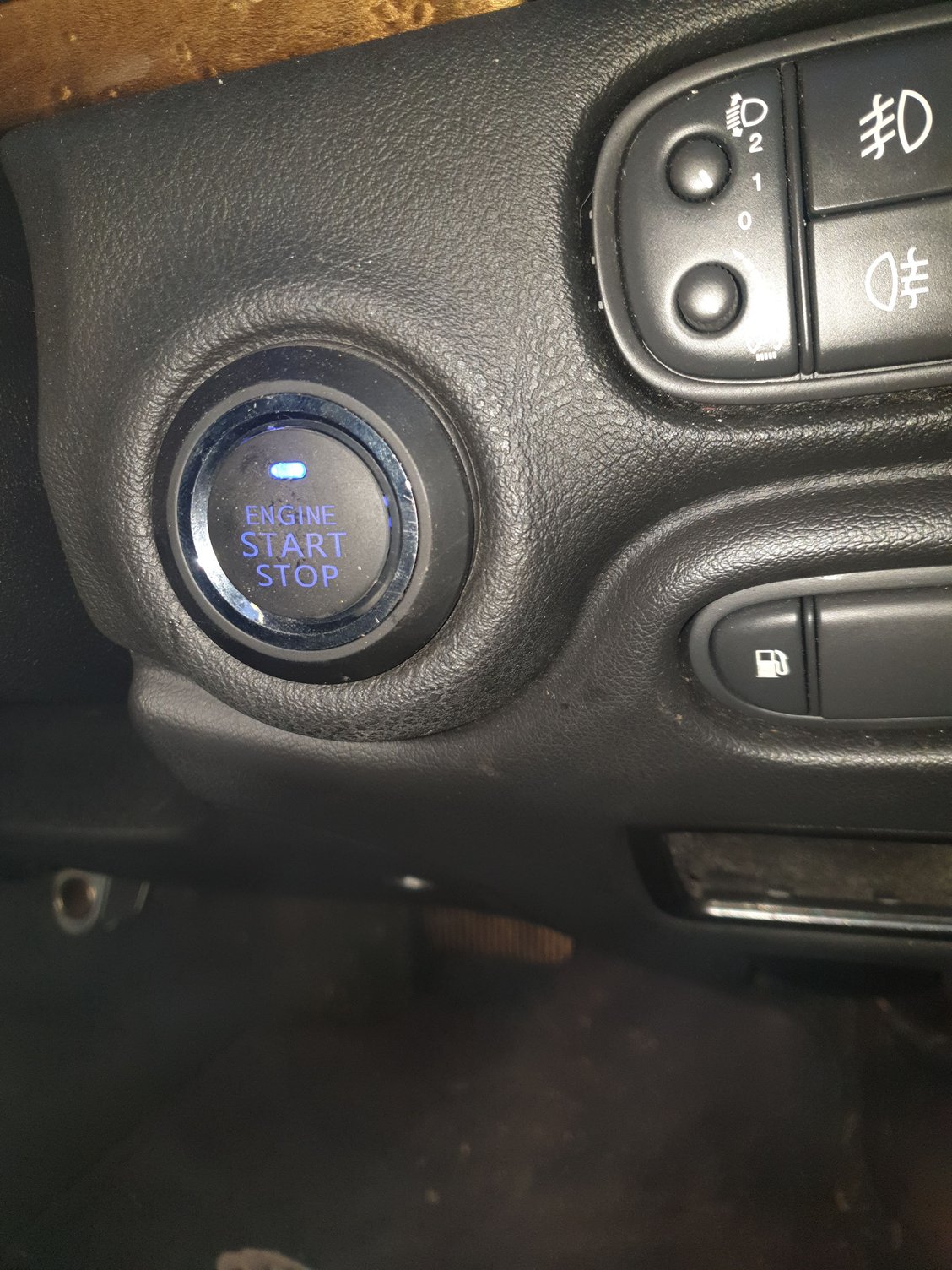

hi I have gotten so far with a keyless entry remote push button start for my 2004 s type 4.2
i can start engine via remote control or with the push button start
Car runs perfectly
I have got car to lock as I walk away
the problem i am struggling with is auto unlock
I can get car to auto unlock but if a passenger opens a door the alarm will trigger
Or when I open driver's door alarm will start to do the beeping and I have to push the start button
I am thinking about trying to disable the alarm to the horn
But not sure if it can be done
So at the moment I am using factory remote to unlock only
I have also installed transponder chip in push button remote

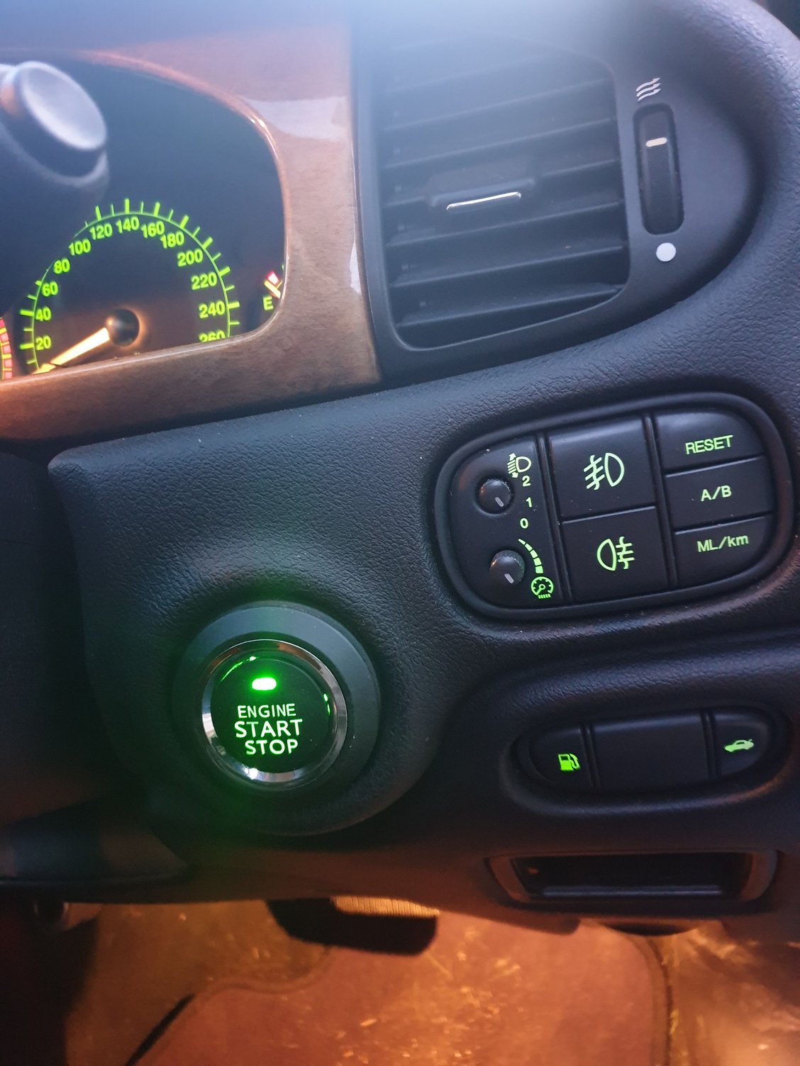

Blue light is on acc1 acc2
green light engine running
Willing to help you and hopefully we can work together
