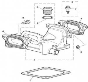

I think you are talking about gasket # NCC7735BA. Which is #5 in the diagram? I think Jaguar of Greenville had it for $45?

Well, I'm going to order parts tomorrow and hopefully get working on it this weekend. The repair is a little bit of pain, but it's not nearly as bad as removing the supercharger. I'll have to remove the inlet tube, undo the intercoolers from the y metal piece(part 1 in the diagram above) and I'll have to remove the bypass tube off the supercharger. I don't recall if I need to remove much more, but hopefully not!
