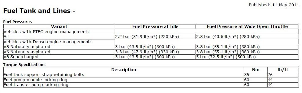

Sorry been down with the flu... I plugged my scanner in and the only code present is low pressure on common rail.
Old Nov 15, 2019 | 12:29 PM
NBCat's Avatar
Posts: 6,068
Likes: 2,983
The fuel system specifications for the X200/202 are listed above. Test the fuel pressure and compare it to what's shown. It's possible you have a clogged fuel filter or failing fuel pump.
Thanks for Awesome information I just replaced the fuel filter I will hook my gauges to it today and check the pressure.
