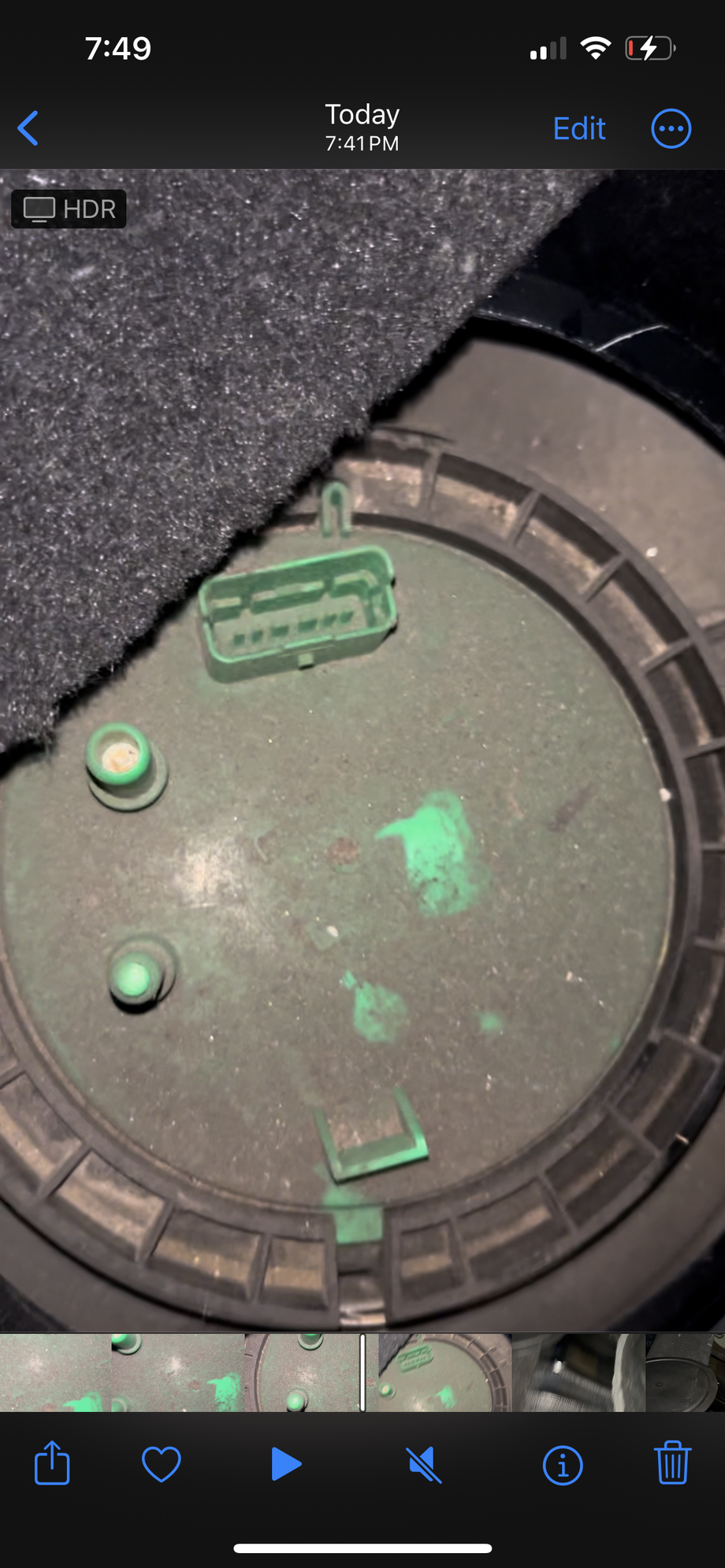

No Fuel pump B (no wiring harness either
Fuel pump A

look at your absolute fuel rail pressure pids. one accounts for manifold pressure the other is referenced to baro
low fuel delivery is never an issue on the 206 single pump models
