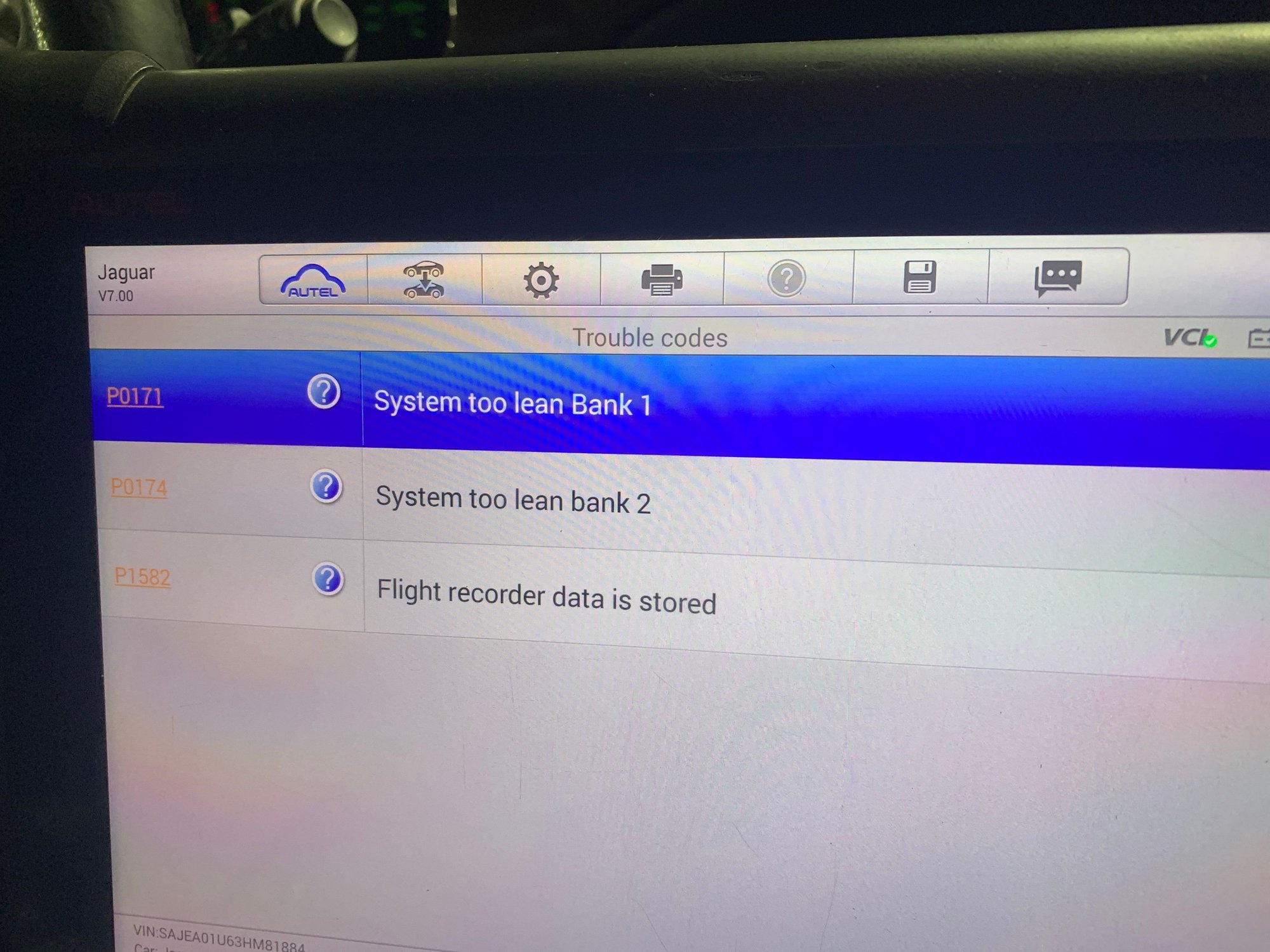

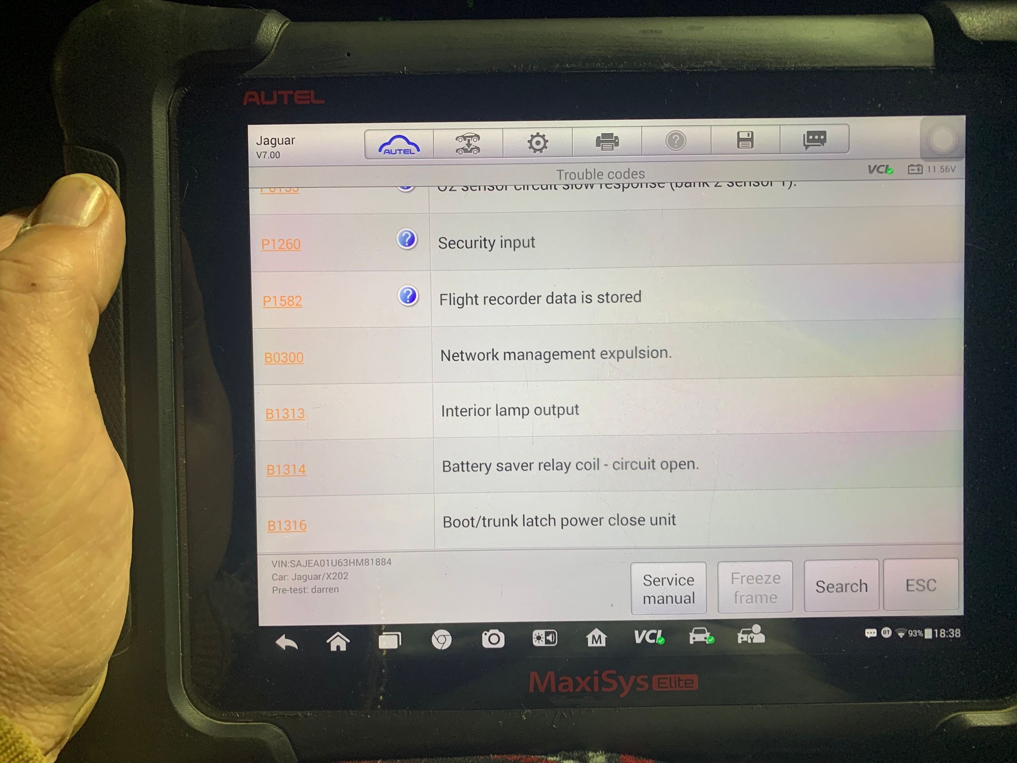

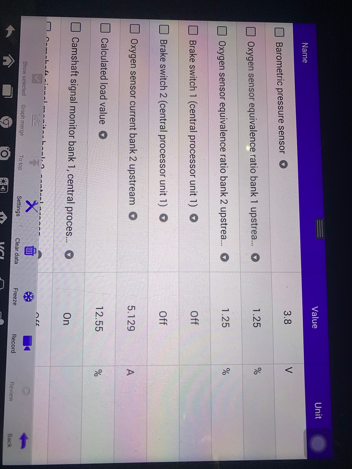

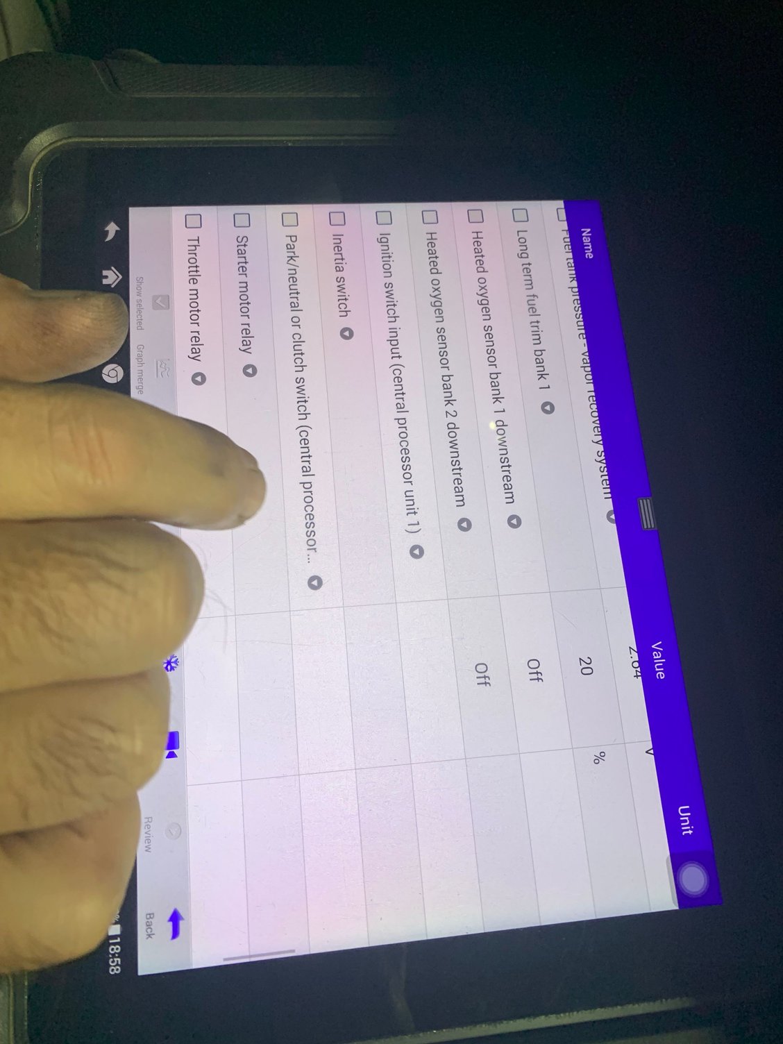

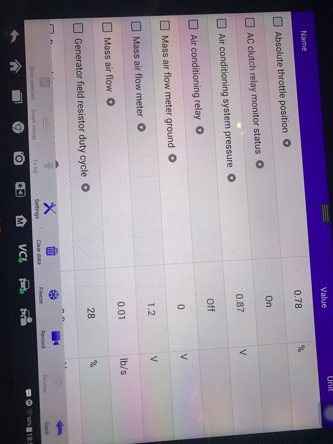

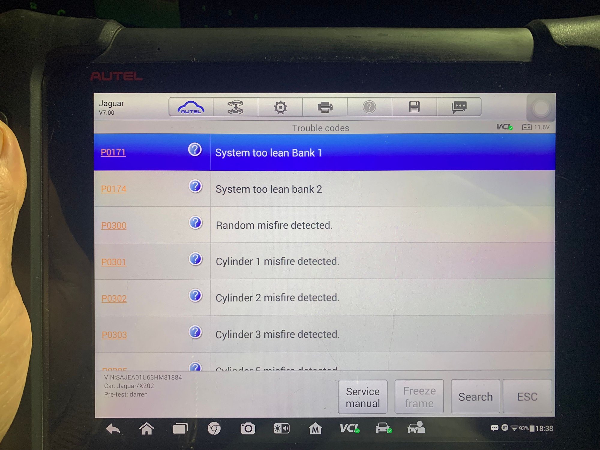

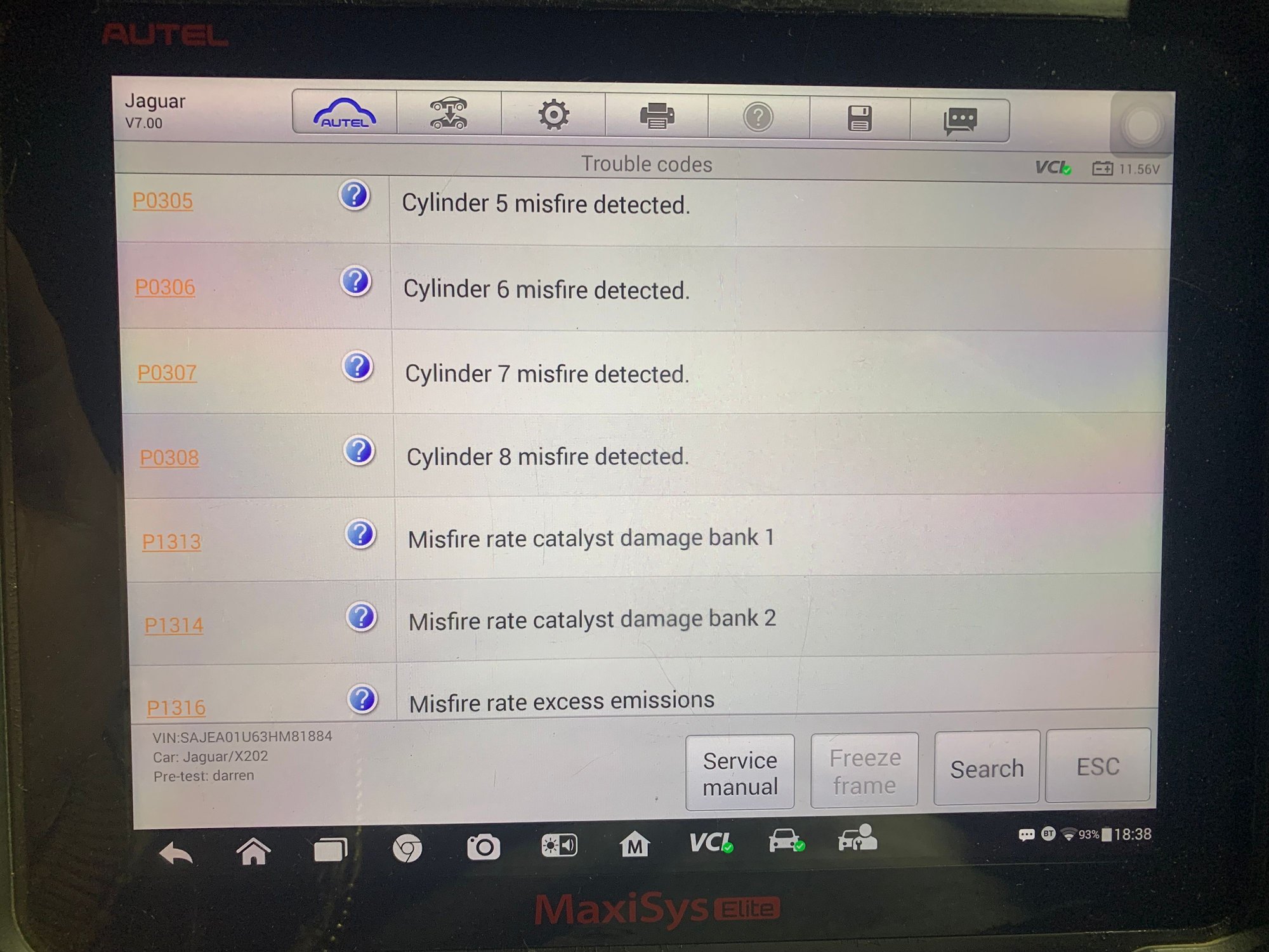

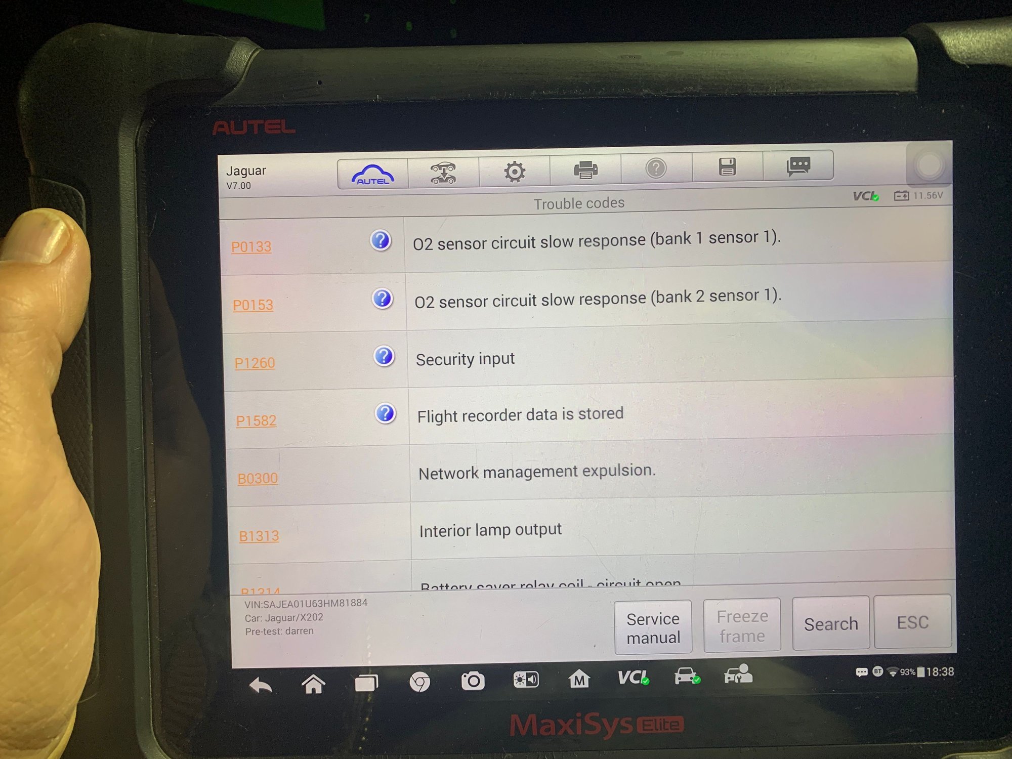

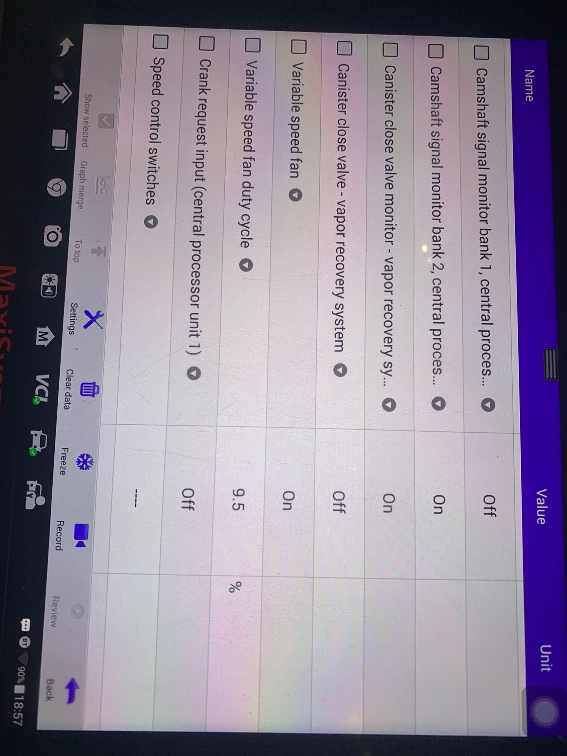

Ok so I was able to get into his shop tonight and these are the logs. There are 2 sets. 1 from before a clear codes and 1after.
First set
First set

After a clear you need minimum of 2 warm ups to give things a chance to re-flag.
Before the clear it looks very ill, with what may be very bad upstream O2 sensors. The misfires may be causing serious catalyst damage.
