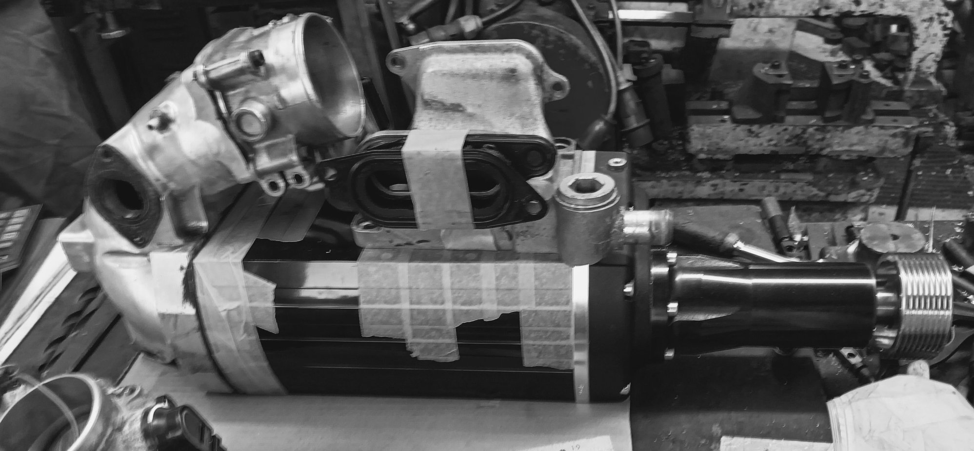

Not sure about 60hp, but if you want 600+hp I have 2.6 KB kits I can make. I can also make the kit with a 2.1 supercharger for over 500bhp. Below is a picture of one we're just mocking up with a bored TB, but we're going to re-make the rear elbow with some improvements.
about how much would the kit cost?

If you are interested, send me a PM and I can price up a kit depending on size of unit, TB, injectors etc.
