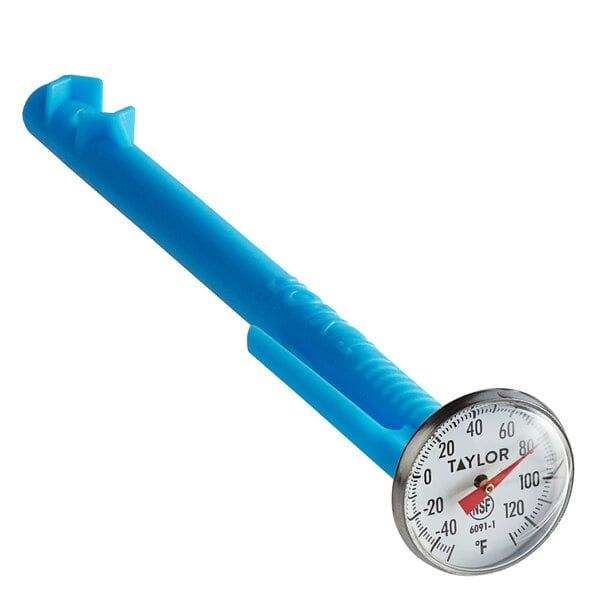

I highly recommend one of those little thermometers, inserted in the center dash vent. Some numbers will really help with troubleshooting, for comparison to ambient. You may be getting a little bit of heating but that would be tricky to discern with the back of your hand.
