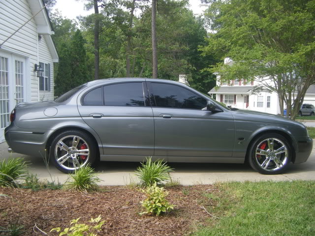

The tint is for staying cool. I'm not going to take it off cause the whole reason I got it was because I was supposed to be moving to Florida where tint is a necessity. The air works so much better when you are blocking the UV's. If you remove tint you risk pulling the rear defrost off. So I'll just have to deal with it.
Vance, I used to believe the same thing about the rear defrost until I started doing a little research. It's an urban legend lol or shall I say something the tint shops use to charge you more to remove it. I purchased a car with OLD purple illegal tint on it and had it removed in my driveway with zero problems. Oh, don't ever let someone try to do your windows in two pieces. It's one piece or nothing!
Old tint (install unknown but at least 5-10 years)
Tint removed with rear defrost intact
