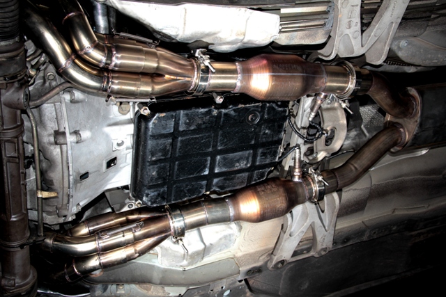

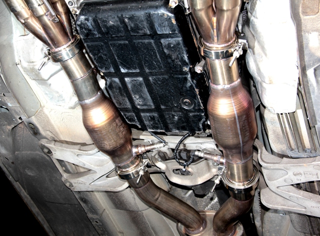

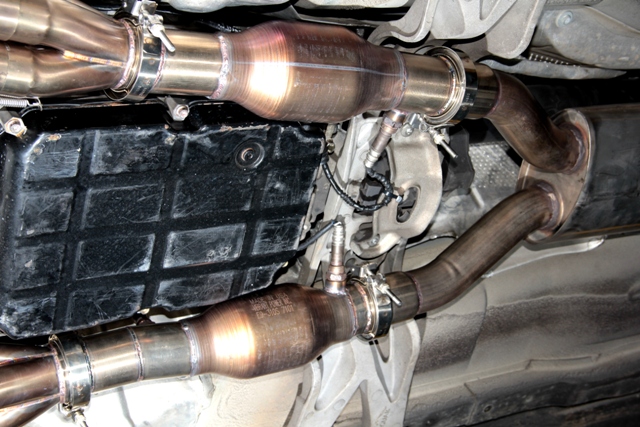

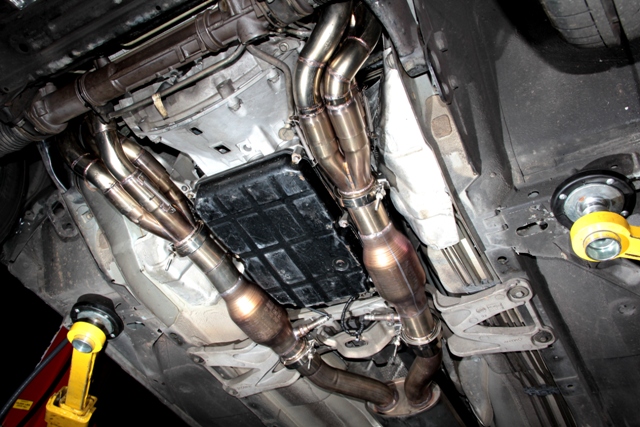

Here are a few pics of the headers with the cats in and we will have some results for you guys to look at tomorrow. Have a great evening and enjoy the pics and let us know what you think!

Looks like a 2.5" diameter system. Is this beast gunna B loud?

Nice, by saying commit i hope you meen pay first. Having done several group buys with other products. Money talks b.s. Walks lots of people say do it ill buy it. You do it and.......hello. Is there anybody out there? Just nod if you can hear me. Is there anyone at all.....
Many times i buy things and dont have time to wait for a group buy to get together. They can be hellish. other times its the only way to get a product produced and to market
NICE QUALITY FROM THE PICS

The craftsmanship does look pretty dang good on those puppies. Like em!
The only thing about headers is the heat. Hopefully the factory shields are up to snuff, and any other parts in the general area that were not protected are now(?). With the looks of this install & quality of parts, I'd be confident that the intallers did take that into consideration.
Header wraps have pros/cons - I wrapped my stainless Borla header on my Jeep more to help keep my toes from frying on the floorpan (no carpet and the thermo mats still were not keeping it cool enough) than anything else, but I'd rather not wrap if i didn't have to do so.

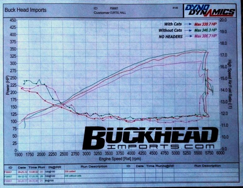

So here are the results with the cats installed, not bad. Minimal loss in power at redline, lost a few in torque under 3K rpm. Any questions please ask. Not bad with 200 cell cats.

Can you show the A/F ratio per run?

Sure thing here you go Avos!

close enough to play with the tune if you have cats to get more power.

Tony, couldn't enlarge dyno sheet. What were the results?

306.7 before headers (baseline)
339.7 w/Cats
346.3 wo/Cats
