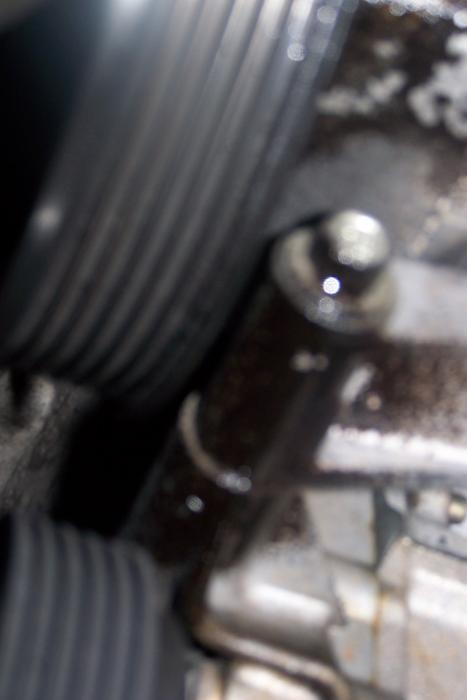

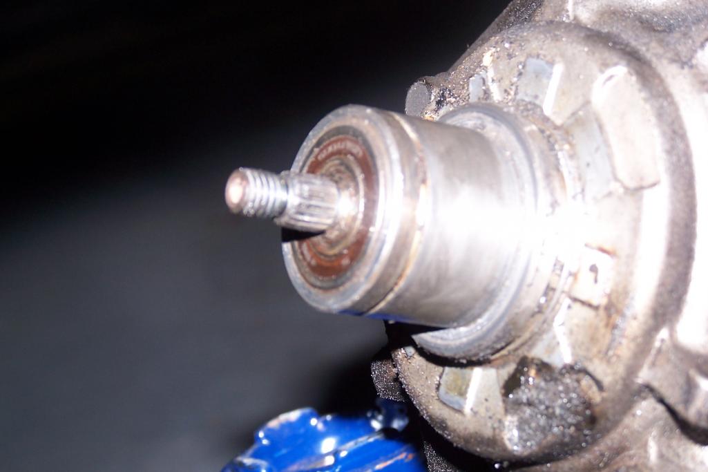

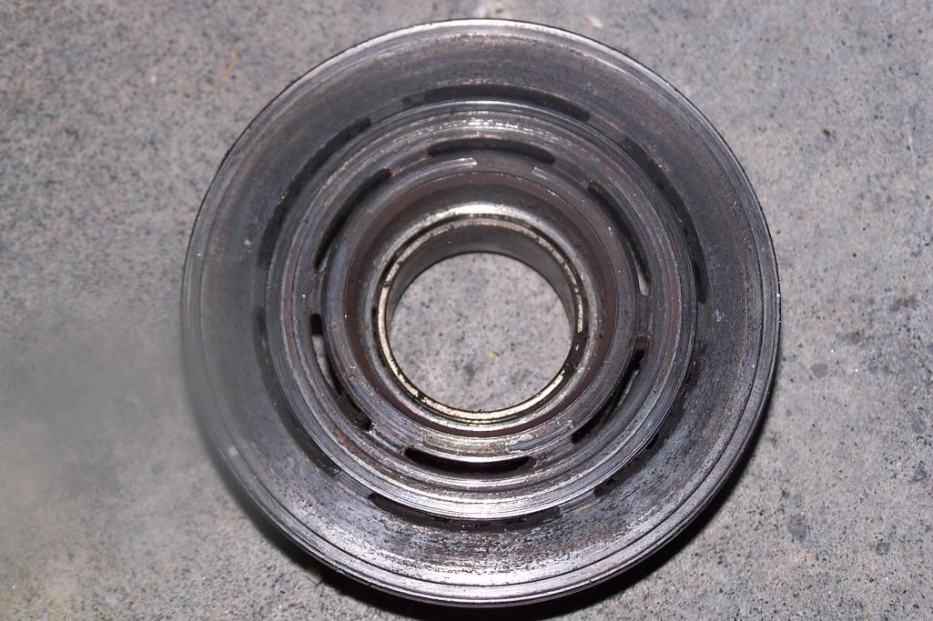

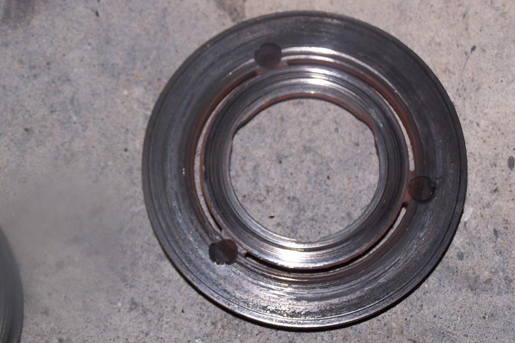

Pictures as promised and final analysis
CoilA/C compressor and clutch assembly-100_8705.jpg
PulleyA/C compressor and clutch assembly-100_8707.jpg
Clutch hubA/C compressor and clutch assembly-100_8708.jpg
CompressorA/C compressor and clutch assembly-100_8709.jpg
Black goo found above compressor pulleyA/C compressor and clutch assembly-100_8711.jpg
Right or wrong this is my analysis. It looks like the bearing on the pulley drive locked up causing a lot of friction/heat which caused the coil insulation to melt which led to the coil to fail and possibly leading to compressor bearing failure.
