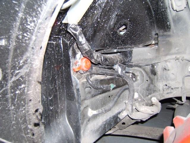

Also, in a REAL emergency (... =:-0 ) there are extra battery "terminals" under the fender liner on the passenger side of the car. If the battery is dead and for some reason the trunk cannot be opened, the fender liner can be removed (a real pain, but still) and the electrical "posts" will be found.
Was surprised to learn that, don't know if it is described anywhere, didn't notice it in the owner's manuals.

Here is the AUX battery post. This is on a Lincoln LS but it's the same.
Attached Thumbnails Dead Battery? How to Open Trunk.-front-wheel-well-battery-post.jpg
Old Dec 6, 2013 | 12:42 PM
pab's Avatar
pab
Posts: 1,766
Likes: 246
From: Boston
Right that's it, and I'd forgotten that it was only the + terminal.
PIA to get the liner out, though...

Old Dec 6, 2013 | 02:33 PM
tbird6's Avatar
Joined: Jun 2009
Posts: 3,899
Likes: 803
From: Home
Yes not great but at least it there!

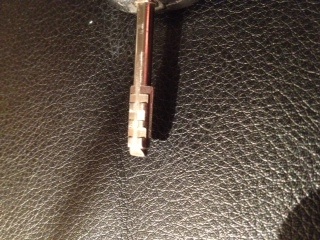

Originally Posted by Mikey
Maybe this is a good time to remind all owners to go try their keys in the boot/trunk release to make sure it works.
I've tried the key that came with car and it will not open the trunk. I did confirm that the valet button was disabled. From the attached pic of my key does it look to be a valet key?
