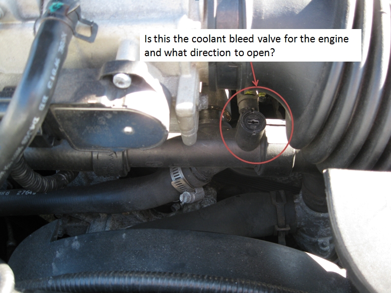

Where is the engine air bleed located? It is supposed to be at the crossover pipe but I am unable to find it? I found the one for the tank.

Gus dont use that bleeder unless you want to relace that upper rad hose assembly too. its the end of the small hose right in front of the reservoir pointed towards the shock mount.

That's the bleed alright. It gets a turn 90 degrees counter-clockwise to open, then is pops up but stays in the pipe. Brutal has a point about using it, after a while it gets brittle and can break. That means replacing the entire hose/pipe assembly. Problem is, without using the bleed and trying to get coolant in and the air out, you risk overheating the motor in the process. It's a craps-shoot. I'd recommend spraying it with a silicone lubricant and let it set a while. Then gently rock it back and forth a little at a time, a little farther each time until you get the 90 degrees. If it doesn't start moving with reasonable force, don't push it, it's probably going to break.
