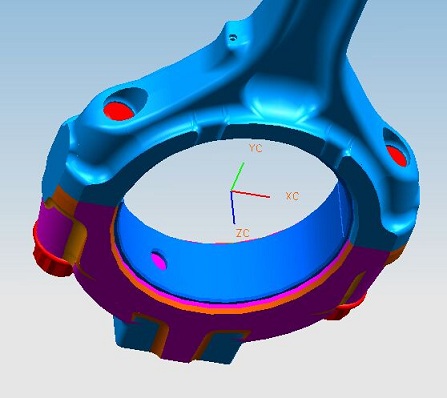

A different style is the Rod style. Keeps the distance from the oil jet to the underside of the piston the same so more consistent oiling. Don't know which is better?
The use of these requires more oil flow so usually a bigger oil pump and maybe some additional internal oil control measures like windage tray modifications and oil drain back stuff.
