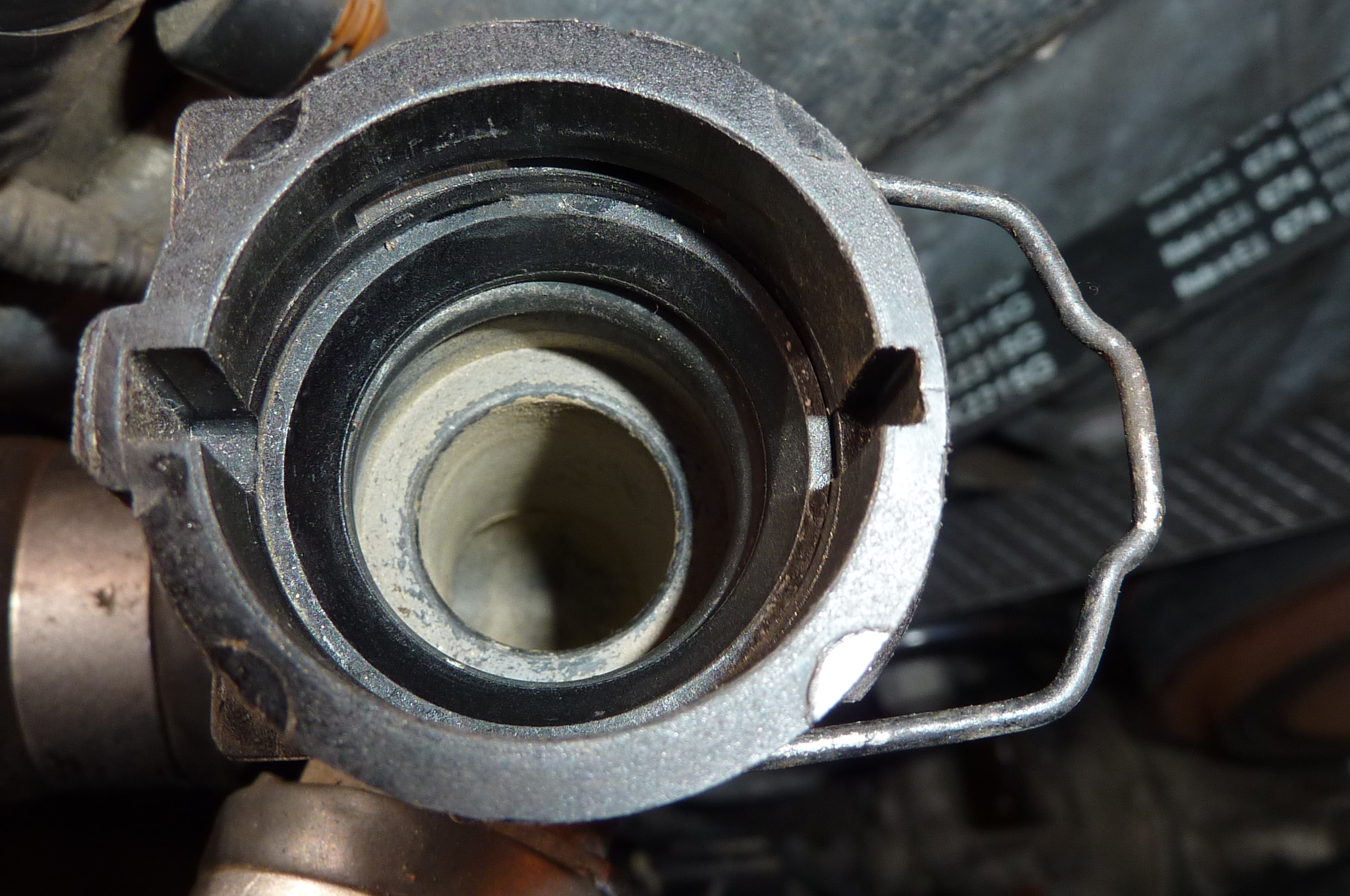

jwhitcraft, not clear what type/model you have! (hint....hint)
But if you pull out the clip on the tank lower connection, as shown. The hose lower shown pull out of the tank.
To refit.
Replace the clip in the hose connection as you have removed it and once the hose is in place on the tank. Pop back the clip into the hose connection fully.
Test the hose is secure? by giving a tug downward.
The important thing about this job............... Is do not drop the pin!

To add to this. When you start the car let it warm up with the hood open. That wire clip connection is hard to clip in correctly. With the hoses attached it will look like it's latched even when it's not.
At least two people have burned up their engines (Including one STR) when they just started driving after installing the top tank. If the fitting is not latched the car will lose so much coolant so fast that you won't even know it until it's all over!
