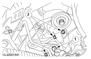

Those 2 hoses go to the oil cooler where the oil filter spins onto.
I'm assuming these are the 2 hoses you're talking about?

Thank you for the pic and response JBzXJ40.
Could these really be the hoses off a lower radiator hose filled with coolant though?
Why would coolant connect to the oil filter, other threads mention these lines going back to the transmission?

You have a 2000 S-Type. The Oil Cooler so to speak is the oil filter housing. The coolant is used to flow through that to cool the oil filter housing (fluid to fluid vs air to fluid). These 2 hoses come off the lower radiator hose. The trans cooler lines run directly to the radiator, but they run down the RH side of the engine.
The later models, 03 and up have a different set up, the trans cooler lines on these models run down on the LH side of the engine.
Just to be clear, your question is in regards to the lower radiator hose, and off that hose has a junction with 2 smaller hoses that run down the LH side of the engine ( with you sitting in driver seat ) correct?
