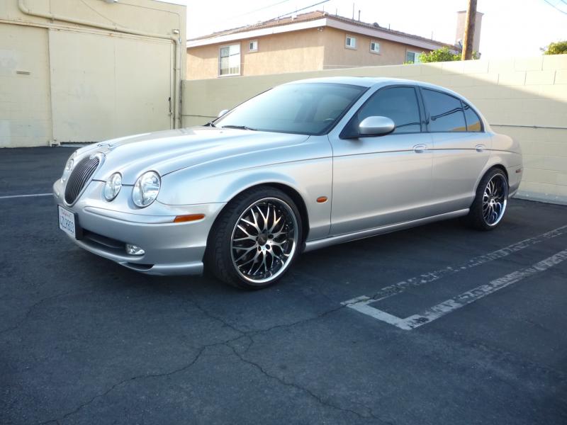

some before shots look at the space in the wheel wells
Attached Thumbnails Lowered my Kitty today!-boss-b4-h-r.jpg   Lowered my Kitty today!-boss-b4-h-r1.jpg   Lowered my Kitty today!-boss-b4-h-r2.jpg

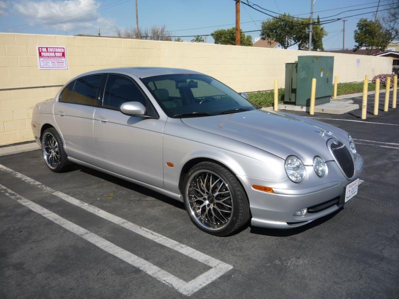

here are the After shots...Loving the stance of these H&R Springs!
Attached Thumbnails Lowered my Kitty today!-boss-h-r.jpg   Lowered my Kitty today!-boss-h-r1.jpg
