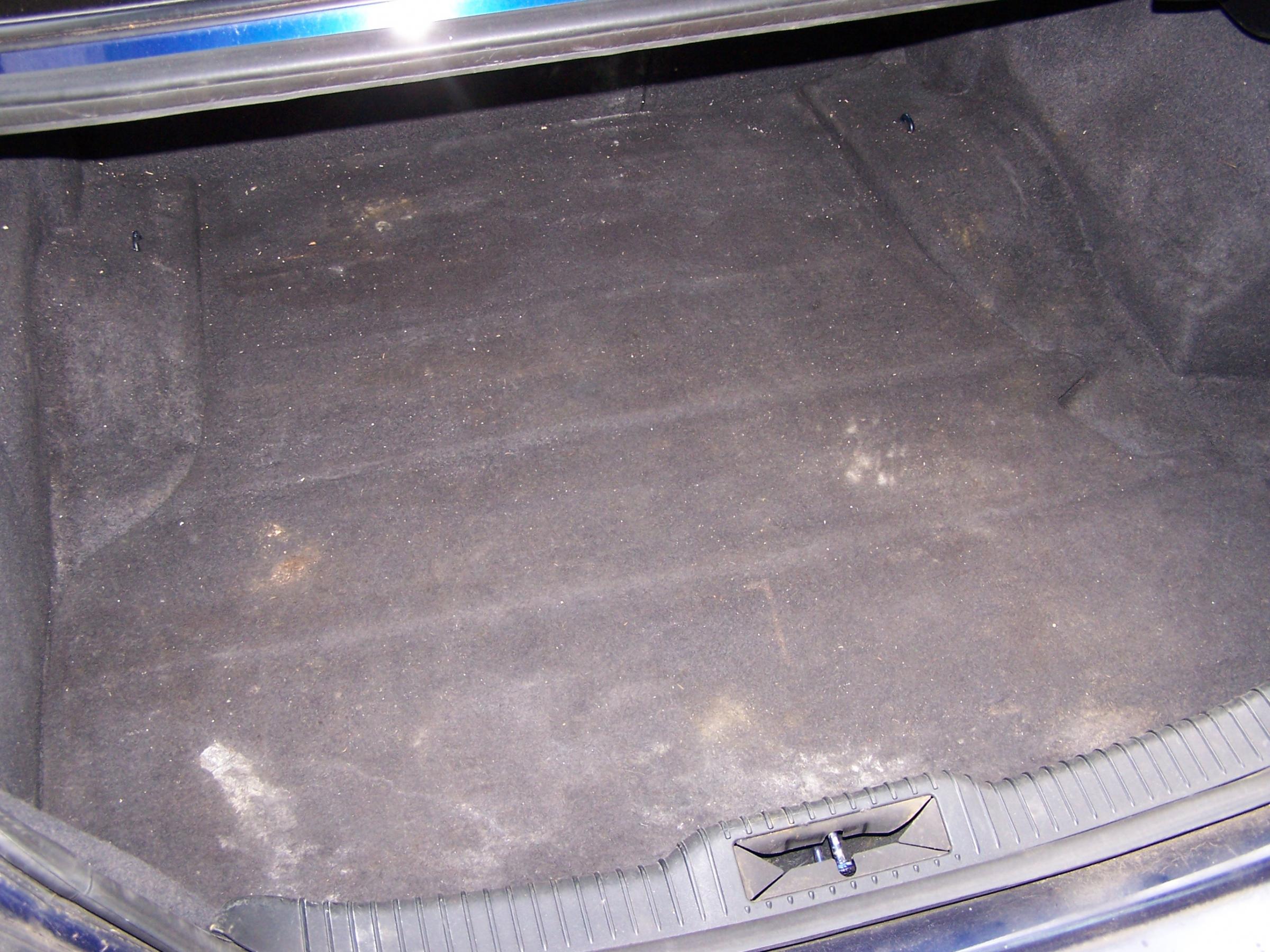

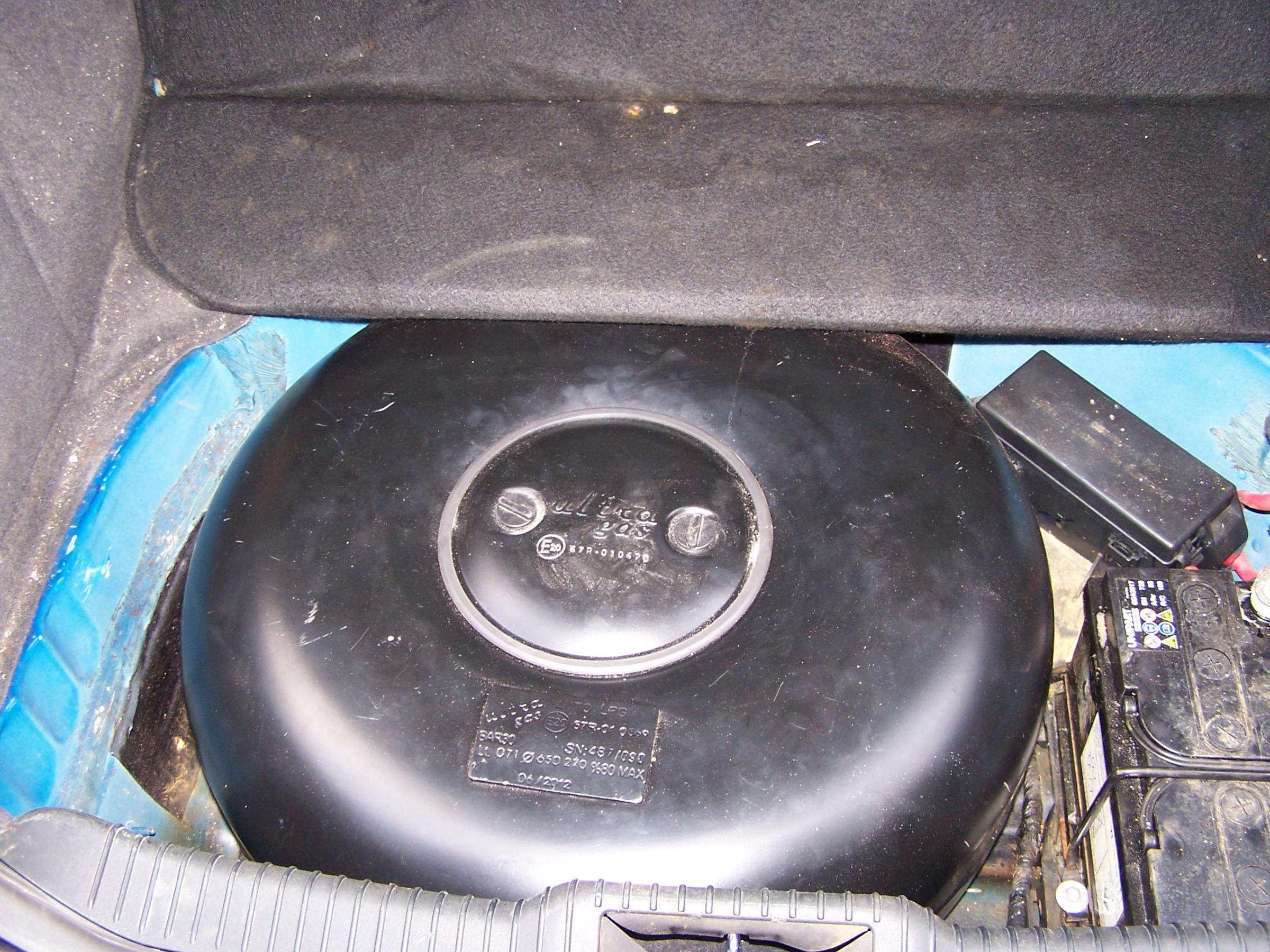

That the tank fitted in the boot of my 'S' type.
Dead easy. One 50mm hole for the pipes and cables, and two 14mm holes for the mounting!
I was wanting to fit a larger one, but it wouldn't quite fit without moving the electrics and I didn't like the idea of that. This one will give me 54lt usable (just under 12 imp gal)
I'll run the pipe and cables to the front over the weekend.

That's the easy bit completed.
Put your car info in your signature and we'll then know what year and model you're talking about.
Best posting on the .co.uk forum if you've got any questions about your lpg conversion....I did mine 6 years ago.
