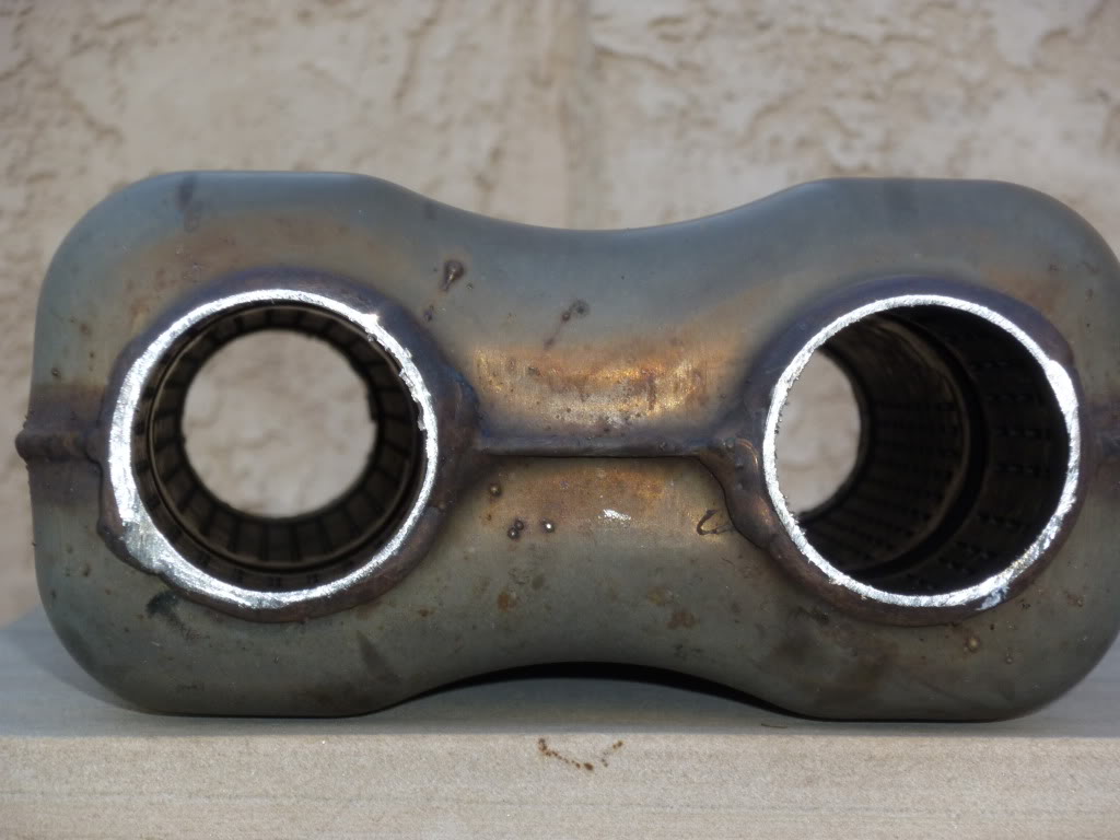

Below are the pics of the stock resonator. As you can tell its straight through, with NO crossover point. Its super heavy. I am surprised this thing has so much sound suppression.

If you rip apart the stock resonator you'll see the cross over point. It's hidden by the baffling. I had it ripped apart, it's there. Without it the exhaust note would terminate with a "Braap" reverberating sound. Your cat still has either a leak or O2 sensor issue (wires, sensor, or both). Place a pair of 14"- 18" flow through resonators before the rear axle. This'll definitely solve the excessive noise, smoothing her out. Or you can remove the x-pipe and place Magnaflows dual inlet/outlet x-pipe-muffler. A few of our forum members performed this and love that they don't need dual resonators berore the rear axle and it's slight bark with eventual mellow cruise note.
