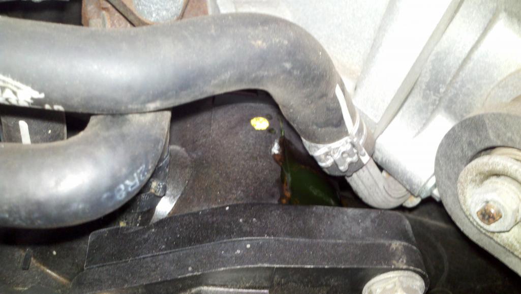

Hey Gang,
I have a small leak in the cooling system that I just located today via pressure testing. It's from a plastic housing behind the t/stat housing that the t/stat housing actually bolts to. I'm looking for the proper name of this housing, the part itself, a metal replacement kit, a good way to repair the leaking plastic, or any safe and effective sealers. I'm attaching two photos and please use the yellow dot as a reference. Any help is greatly appreciated.

Default Thermostat housing
The Thermostat housing assemebly will need to be replaced. This part is a two piece part. But don't seperate the part, if you're replacing it. When and if you get the part, you'll see what I'm talking about.

Having some experience repairing broken/damaged plastic parts in video recorders, basically the best repair is with epoxy resin. You need to be sure everything associated with the repair is clean and well abraided to make the resin stick. If you have a pinhole in a plastic part, make sure there is excess resin above and below the hole. Allow a full 24 hours for the resin to set and keep it warm for the duration. As the pressure when in service is not all that high, I can't see any reason for not giving it a try to save money, but do examine the part carefully for any other unsuspected damage that needs fixing. And of course, full testing when reassembled to be absolutely sure it's working properly.

You will need to replace the part. Do not attempt any repair. The plastic has degraded from time and temperature. Any leak you fix now will only last until the next weakest part gives way. A number of people have had these parts leak in various places. When they take things apart it's very common for the plastic to crumble or break further. Look around the part that is leaking and see if any other plastic piece needs to be removed for the repair. Those other plastic pieces might also break when removed. For this same reason used plastic parts would be too big of a gamble. Get new parts from Jaguar.

I agree with tbird6.. You should just replace the part..
Actually the upgraded one is now in Aluminum.. Here’s a link to one I found last night on Ebay for under $50.00

Agree replacement is best. Though using epoxy resin will get you going until you get around to fixing it. Nowadays there are adhesives/fillers that work wonders.

Your plastic likely has the consistancy of dried oatmeal.
Yes, Jag will sell you a MUCH greater assembly than you will appear to need, but I didn't find any alternative, at least for the 3.0l
