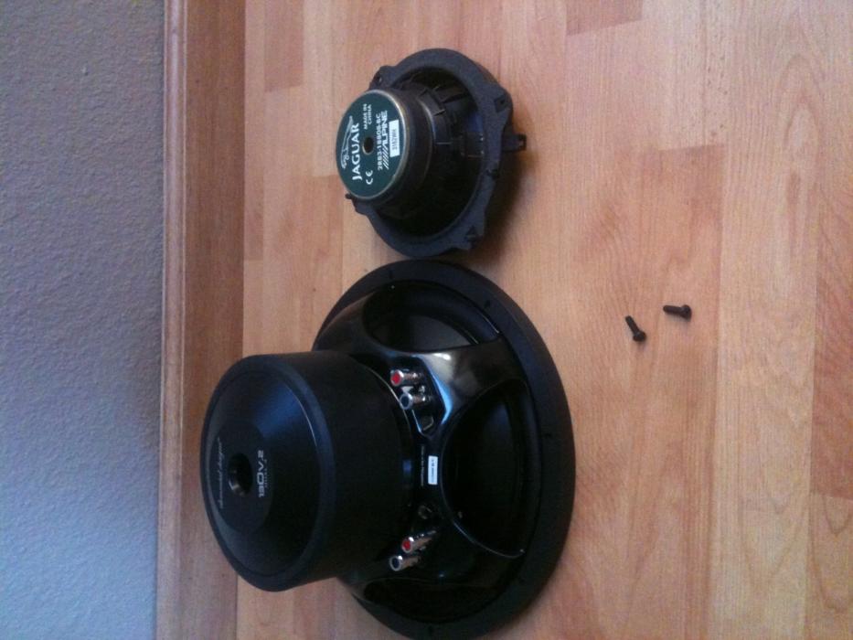

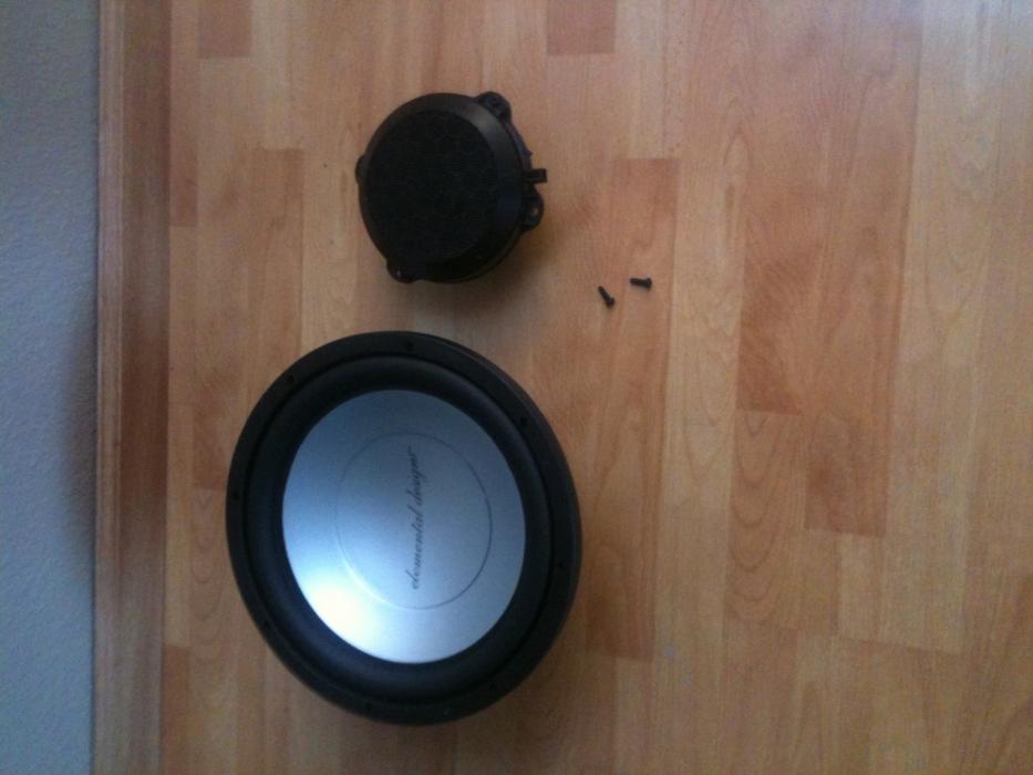

Woww...thanks George! Is it imperative that I hook up an additional amp, or if I stick with the Alpine amp it won't sound right? I'm like clueless with electrical stuff and won't have an idea how to hook an additional Amp up
Also is that low budget 8"sub a free air type?
So basically its just plug and play? The only issue I'm having now is finding the darn wires that are attached to the amp. The previous owner cut the wires it looks like but I can't seem to find them anywhere. Do you happen to have a pic or diagram showing where the wires branch off from the AMP to the Subs?

Hi guys. I thought I'd add some info on my current project into this thread. I currently have a 2004 with the alpine (nav) system. The speakers are stock except for removed subs in the rear deck. I also have the stock alpine amp going into a kenwood 9104d which is nice because it has auto turn on and is really cheap considering it puts out decent power.
I am also running a 12" ported boss enclosure that I got for free a while back. It's okay but the ported enclosure overwhelms the system and makes the lack of mid bass apparent. I'm replacing it with a elemental designs 13ov.2 12" woofer in a 1.13 cu ft3 sealed enclosure. It's super small and the woofer has tons of excursion to really kick out the bass. It'll have good output with audiophile type level sound quality.
I'll try to get some photos of this thing on here. I have a side by side comparison of the ed to the stock alpine sub.
One question... I have a stock very high end (approx $500 a set) rockford fosgate fanatic q set of 5 1/4" compoent speakers sitting in my garage. Will these be a direct bolt in to my door panels? How much depth do we have there? These things have pretty good sized magnets.
Also, has anyone done the q forms kick panels on our cars? There was one car (an s type) on the internet that I saw a while back. If I did this, I'd probably run some kind of amp in the trunk and get a device to mate it to the stock system. The front stage would be more pronounced and the power would be clean.
Buy these:
5X7 6X8 TO 5 1/4 5.25 SPEAKER ADAPTER PLATE MID KIT | eBay
That will let you bolt that 5.25" in place of the stock 5x7. Depth is NOT an issue.
Pass on the q forms, they need a lot of reinforcement not to rattle. Do they even make an S-type specific one?
