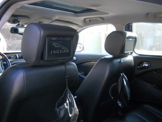

Success! I just got my rear video system installed today with the help of my lovely wife. I used the coaxial cable technique without any problems and also used the rear power point instead of pulling my entire center console apart.
I do have one suggestion though if you're going to use the rear power point. After you remove the interior armrest section (where the cupholders are), you'll notice that there's a silver bracket underneath that the two torx screws screw into. You cannot have any cables ABOVE this bracket or else the cupholder section will not fit back in. So take your time to route all your cables underneath this bracket. At the rear of the console, there is an area, just in front of the vents where you can jam in some of your cables.
All in all it was a fairly straight forward install. I did, however, hate sliding around on those bloody leather seats when I was trying to get leverage during the install.
Now I'm just fighting with the SD card and video formats.

As far as the SD cards, I'm using a standard 2GB SD card and not the SDHC. I've got them formatted to Fat32 on my Windows system. Most, if not all, of my videos are in XVID avi format which is supported by the system. The problem I have is that only a few of the movies I have play on the system which is weird as they're all XVID. What I'm wondering is if there is an older codec on the system and all my movies are in a newer XVID codec, therefore aren't being recognized... It's a bit frustrating really.
I've noticed another couple things that I'm a bit disappointed with - the first is the headsets. There's a constant static style noise on them, kind of like a cross between a humm and the sound of the ocean. It's noticeable over the sound of the movies. The other thing is that the video playback isn't all that great from the SD card. Mine tends to get lego-blocky and jumps a fair bit. I haven't tried running an external DVD player through the external inputs yet. We'll probably play most of our movies this way as we have a huge library of kids movies on DVD.
Thoughts anyone?
Looks good man! How's the car running?
Take care,
George
LOL! Thanks George! Anytime I want to post a pic of my S-type I have to clean it though - gotta keep an eye out for that Rick character. He's always looking for the dust bunnies on my ride. Especially now that I've pointed out a few on his!
As for the car, she's riding like a dream. I'm just stumped about what came off my engine. I've purposefully parked her in the same spot on the driveway, but I haven't had a single drop come off of her. I'm going to book a date with my mechanic to have her on the hoist shortly to I can really have a good look.
My kids are happy though with the new video system! Almost makes me want to be a passenger once and a while....nah! Who am I kidding......
