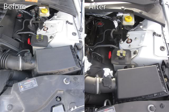

Hello again! I want to thank you guys for your input on my engine cleaning project - it really helped.
I started in the morning today, around 10am and wasn't finished until 5pm tonight. I cleaned and detailed the engine, washed, clayed and waxed the exterior and detailed the interior. Needless to say - I'm sore. I took the time to have a good look around the engine bay, and anything that look the least bit "electrical" got covered in tin foil. After cleaning, I started the engine up to help with the drying process and let her sit all day to finish it off. I took my jag for a spin up and down the highway with no limp mode in sight (but still keeping my fingers crossed for my 2hr trip tomorrow)
My S type has never looked better!
Here's a collection of photos I took of my engine compartment.
Here's an overall before/after pic of my engine :

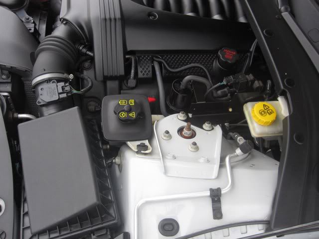

Another before and after pic :

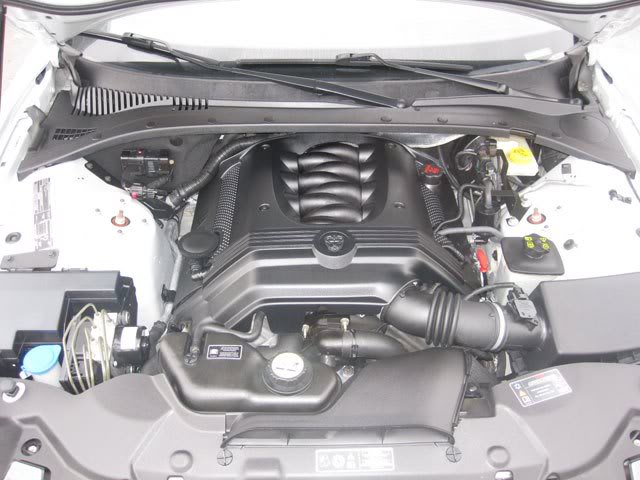

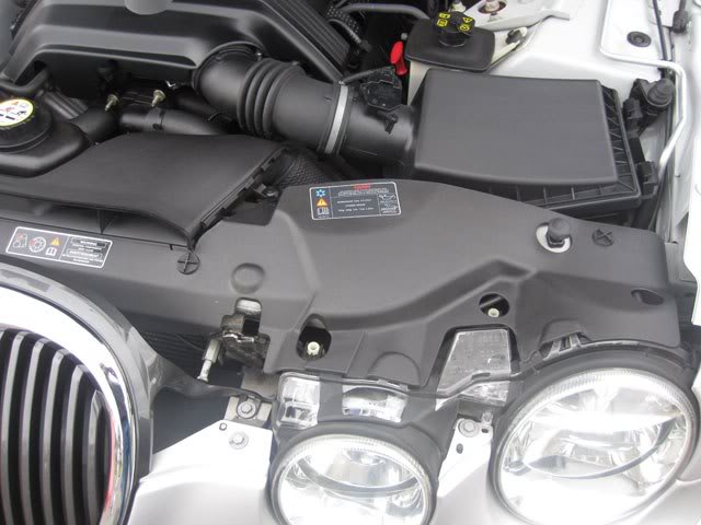

A photo journey around the engine bay :

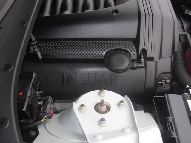

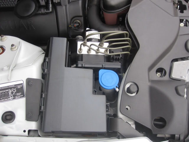

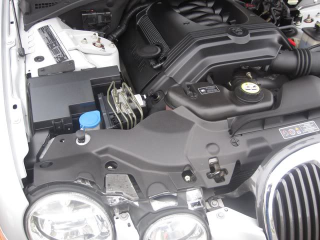

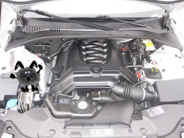

Just when I thought I was finished, this guy appeared. I knew Rick would spot him right away and point him out to me so I tackled him right away!

I hope you guys enjoy the pics! For those thinking about tackling this project themselves - go for it - but plan on spending some time on your engine. You really have no idea how many nook and crannies there are in there until you start trying to clean them!

Looks Fabulous Rob!!!! GREAT JOB! I am sorry I was under the impression you have the 3.0 for some reason.

That looks new, fantastic job
