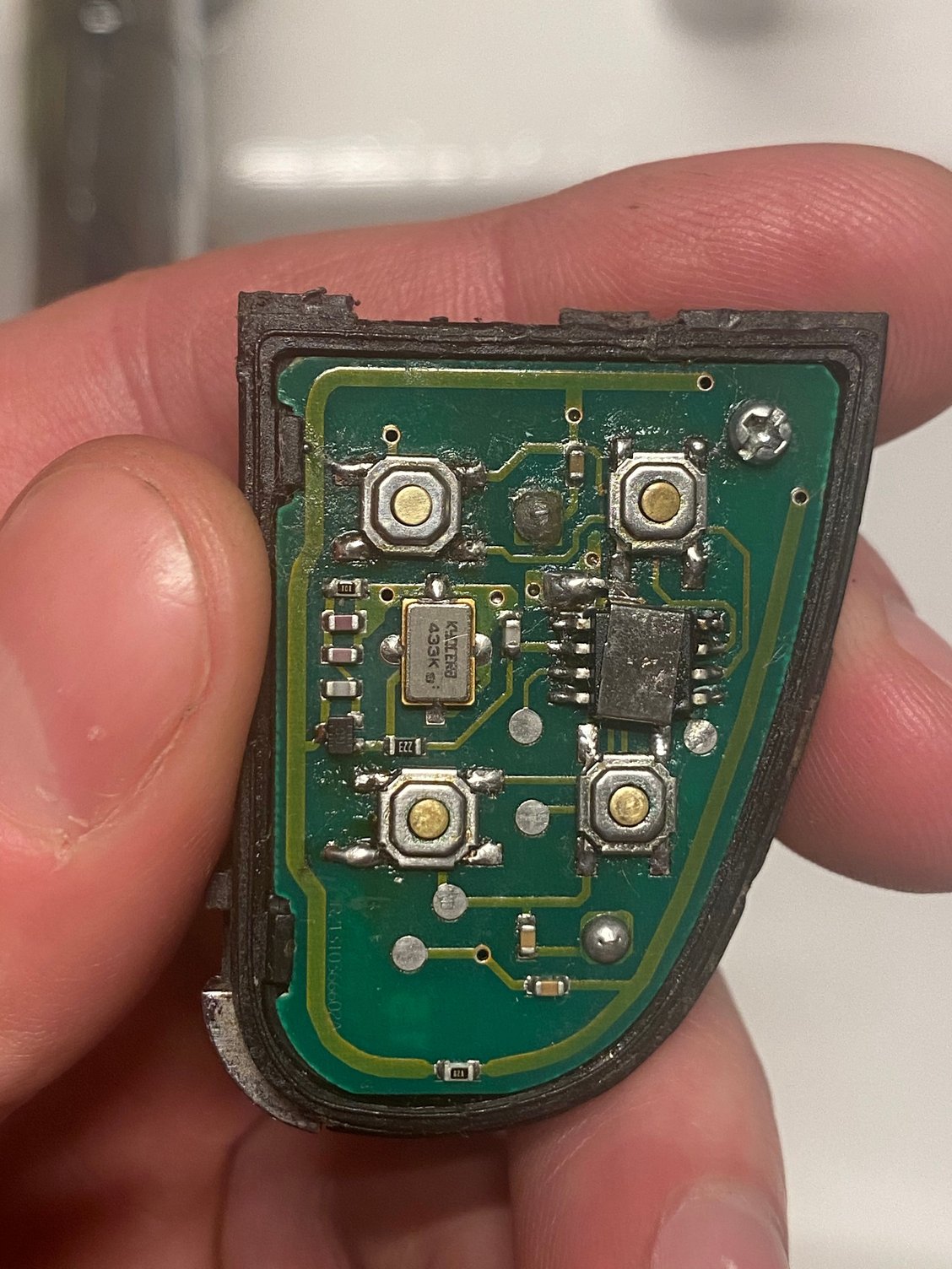

UPDATE
Hi!
i have good news, and as i said i will post the same here as well since there are a lot of people with this type of problems that include hard working buttons or specific dead buttons, even though they replaced their micro contacts.
Today i dropped my key and i had to change a microcontact (button) that ceased to work.
While i was there i applied flux on all connections and used a 40W soldiering iron to refresh all connections including the chips, resistors and other small parts.
i had problems with my panic/lights button so i bridged the bottom left connection to its trace on the board, next to it.
key works wonders now. All buttons work and they work soft and with ease.
so my problem was some bad connection, most likely a cracked soldier point? Maybe.
but if you have those aforementioned problems with your fob, just reflow the board and voila

By the way, i consider this topic concluded and here is my fix
my trick to quick repair keys (that spontaneously lose connection) to the s type works in most cases.
also the problem woth pressing hard on the buttons / dead specific buttons is now fixed

UPDATE: i have also fixed my friend's Xtype key. same procedure as on mine. Works now!

Dropping the key fob too many times can cause broken solder joint that it’s almost invisible to see so you’re probably on the right path to creating this problem
yea drops and age, but no one could told me a reflow can fix the hardly working remotes, so now im telling others
