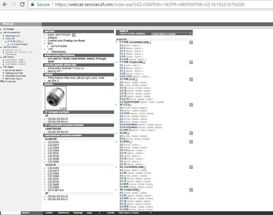

Fitment comes from the ZF website, they are the OEM manufacturer and supplier to automanufacturers. These bushings should fit ANY Jaguar S Type (3.0, 4.2, STR, doesn't matter), XF, XJ, F Type, and earlier Lincoln LS's. I believe they should fit any LS, but ZF's website does not have that information. I did measure a bushing on an 03 junk yard LS to confirm.
Earlier cars using this bushing (pre 04 I believe) used a slightly longer version (59 mm) at the wheel hub, so newer version (54mm) can be used with spacers.
These are a simple press in and out item. I made a simple tool using one of the old bushings to press the new ones in, see photo below. As you can see from the corrosion inside, these get pretty nasty inside. To press the new ones in without destroying the boot, I removed the outer snap ring and ONLY the outer snap ring. This allows the boot to slide up off the end of the center part and creates more room to fit a tool around it to press it in.

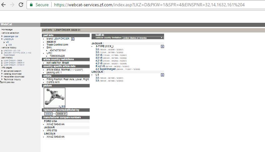

Here are my ZF references for fitment claims. Note: the part number for the control arm of ALL S types is the same, and the same as the LS.
and
The measurements are:
bolt diameter (hole): 14mm (.55in)
Outer diameter: 47.2 mm (1.86in)
Length: 54 mm (2.125in)
ZF numbers
035 264 005 834-03
035 294 005 834-01
Jaguar number
C2C24304
C2C24616
C2C33864
C2C33865
C2C36791
C2C36792
C2C39585
C2C39586
GX73-5B719-A
