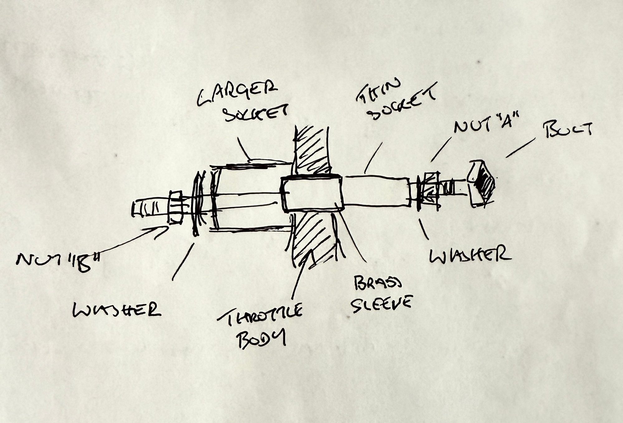

...two 1/4" drive sockets, one fits flush with brass connector, and one that will fit on the TB surround. A bolt goes through from the inside if the TB, through a nut "A"(to hold the bolt head to where you have access) then a washer to bear up against a 9/32" socket (bearing against the brass connector) then through the brass connector to a 9/16" socket (bearing against the TB) then through another washer and finally another nut "B".
To use, just tighten Nut-A down the bolt to where you comfortably have access to the bolt head from the inside of the TB. Hold that bolt head with a wrench / spanner.
Now tighten Nut-B and you will pull the insert out. No need to remove from the vehicle.
Same press can be used in reverse.
Phil
