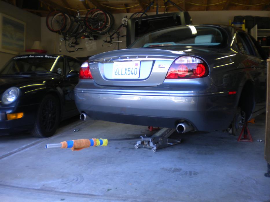

Removing wheels today so I can take in tomarrow to have repaired and powder coated. Any tips on safely storing car on 4 jack stands with no wheels for 5 days.

Don't let the kids near car.

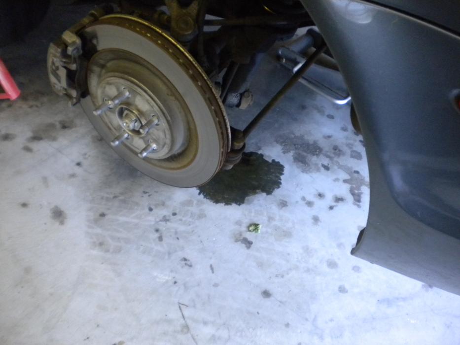

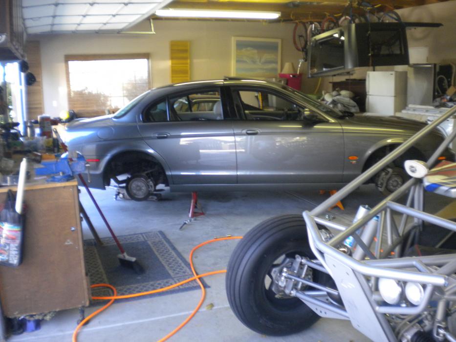

Ran into a snag yesterday when one lugnut stripped an dcould not be removed there is a stainless sleeve over the lugnut . So i rand the car over to a freind that owns a body shop this a.m. and with about 45 minutes and some cool tools that I dont have we got it off. I returned home to take wheels off and get them to the shop for r & r and powder coating. Then back to my office and try to catch up, nothing is ever easy.
Also noticed a pddle of oil under left reat strut while on stands, is the strut bad ? Has anyone had problems with the stock lugnuts ? seems like a poor design.

RE the strut - that's a lot of oil, you'll need to replace that strut and the otherside while you are at it. Did you happen to let the axle hang unsupported during your jacking up operation? It's happened to me when the car goes up on a lift and the shocks/struts are sort of hyperexteneded that's when they leak.
now...tell me about that buggy!!

for sure replacing lug nuts = no brainer. currently the struts are all unsupported up on jack stands, thats when the left rear lost fluid. I am going to intall H&R springs guess struts also.
