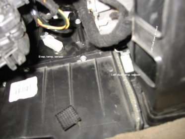

Old Feb 13, 2009 | 12:23 AM
HP774's Avatar
Joined: Jan 2008
Posts: 11
Default Sensors location
The sensors are located in the footwell on the right side of the throtle pedal. If you put you head in there you should see what is on the attached picture (sorry allowed size makes it unreadable!).
The evaporator sensor is the one in the middle and is hard to pull out but it is coming. The other one on the side is not very accessible but feasable without removing anything. On the right side there is another sensor at about the same location but there you need to remove the footwell ventilation duct to remove it.
Hope you can sort your problem with this only.
Herve
