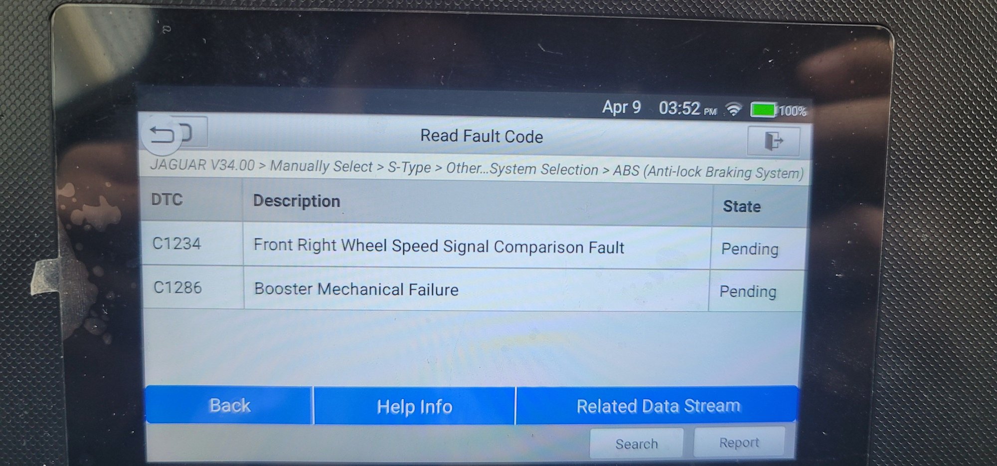

Hey guys. So I got a code finally after driving over 50 mph for a while I got c1234. Says it's my front right wheel sensor is read wrong.
i
I also have that other code and not sure what too make of it ether.

after driving over 50 mph for a while I got c1234. Says it's my front right wheel sensor is read wrong…
Just thinking out loud, but I believe the controller compares all 4 wheel speeds and votes the oddball off the island. This might explain why the car pulls left when braking, as the controller doesn’t trust the speed signal from the right front and won’t apply that brake.
The 50 MPH thing? Could be the controller has a different response for high and low speed, and that’s the magic number.
