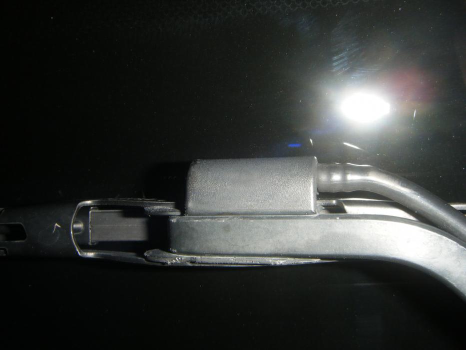

If you want to run Rain-x lattitudes you are going to have to get a different clip. Here are some pics of what I'm talking about. If the Rain-x are the aero type blades I know there is only one kind you can run on the S type just not sure which ones because they would have to be able to accept this clip. The only problem is these were installed on mine by the previous owner so I dont know where you can get them. I'm sure if you look around online you may be able to source them now that you see what they look like. Sorry the pics are blurry but it should give you an idea of what you are looking for.
Hope this helps.

That's because you have an 03.... In 05 they took the washer nozzles off the hood and moulded them into the wiper blade clip! You can see it in Vance's pictures... Absolutely horrible design.. They should have made the nozzles part of the wiper arm... Not the damn clip...
But, I don't have to worry 'bout that any more...
I run Anco's with those clips and they work fine. You just have to remove the Anco clip and replace it with the one on the car. I'm going to be getting a new set of wipers soon and will see what other brands will work. I know in the book I was looking at the other day some manufacturers wipers were not shown as compatable with the S type most likely cause of the nozzle clip. So make sure the blades you are buying are compatable.
