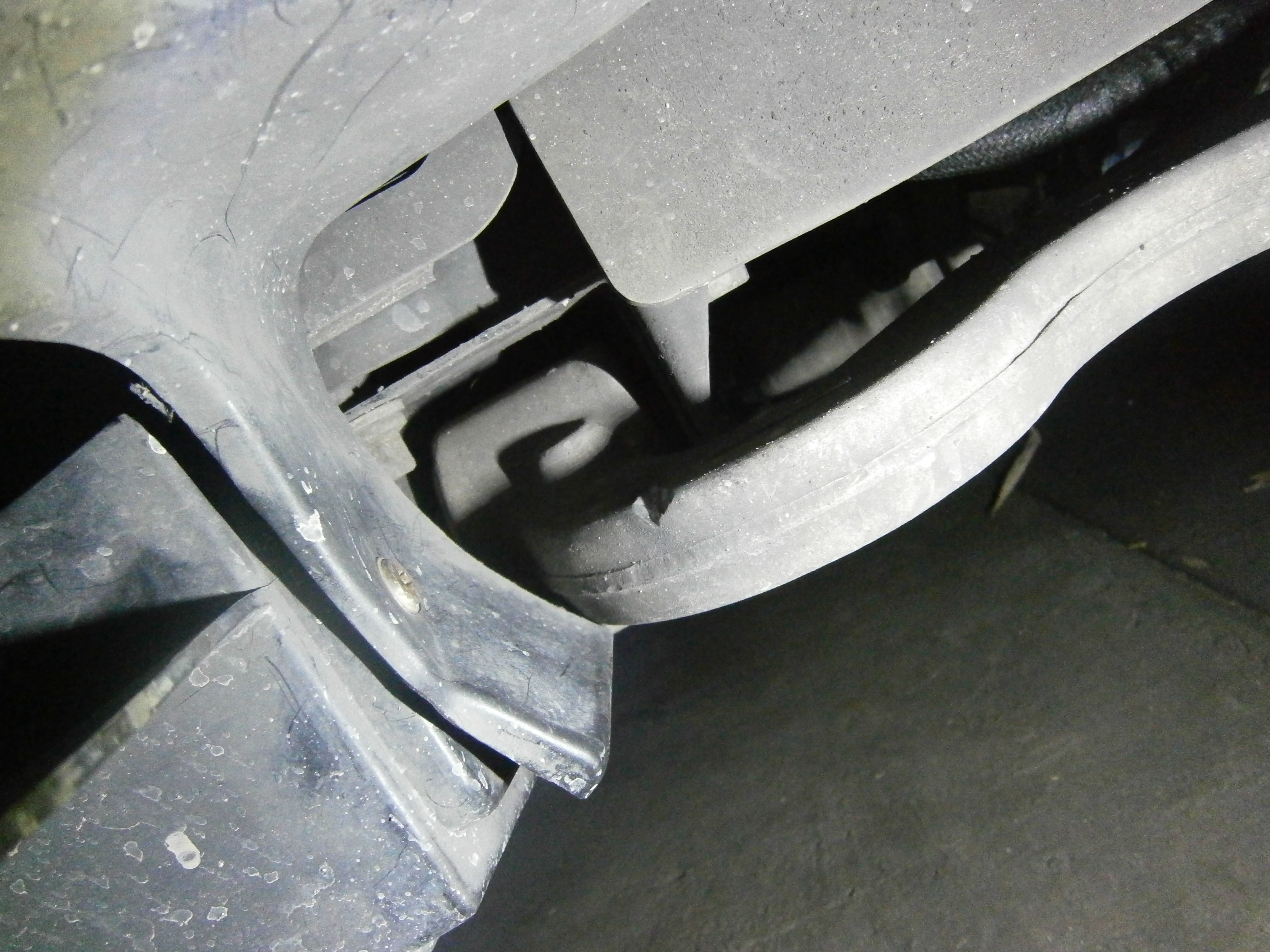

Update:
Looking intently at this thing today.
Nothing out of whack.
Then, this plastic section of the guard liner/undertray was spotted rubbing on the LH lower wishbone.
NO WAY.
No idea how it got like that, maybe ET got upset, dunno.
Thought of simply cutting off, NAH, not the proper way, so made a simple metal strap thingy and installed it under the retaining screw, and now holds the plastic well clear.
Test drive time, and NO sense of achievement at all, but NO noise, silent, and yes, the same roads I got the squawking from were used.
Cheapest fix on any Jag in nearly 50 years of ownership.
NO WAY.

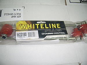

OK,
Updating as required when something gets sorted.
I have been a while working slowly and carefully through everything that pivots in the front end.
Silicone spray on each arm bush, one at a time, and nothing altered.
Graphite grease pumped into the lower balljoints, no change.
Sway bar "D" rubbers off AGAIN, and Rubber Greased, NO change.
Foe some ODD reason I removed the drop links, and worked the sway bar up and down, "feeling" for any oddity to the travel, nothing.
The links "looked" fine, boots intact, etc. BUT, the movement of the pins was "roughish" and erratic, mmmmm.
I had a pair of Whiteline Universal, cut to length 10mm drop links, on hand. What the heck, why not. Cut them to suit, and installed them. The "ball" end is larger than the Jag link, and appears heavier duty???. MUCH smoother operation than the old units.
4 days now, NOT A GROAN, and to my aging seat of pants feel, the ride is smoother. The car "appears" quieter, and that is "her" words, and she is picky.
The Whiteline cost me $40, and the Jag units are more than that EACH, maths did not up.
Looking at the parts listing, the part number for these links changes many times, so maybe Jag do have a problem with them, dunno.
