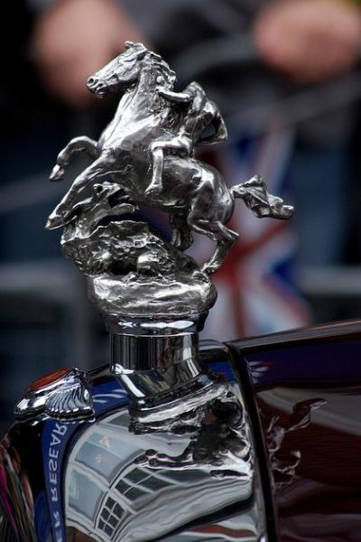

For a better chance of getting away with it, follow ER2's example and leave the number plates and Tax Disc off:
If the 4 ton Bentley doesn't get the pedestrians, the 10" mascot of St George slaying the Dragon should skewer them.
