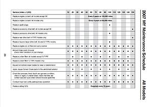

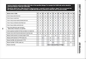

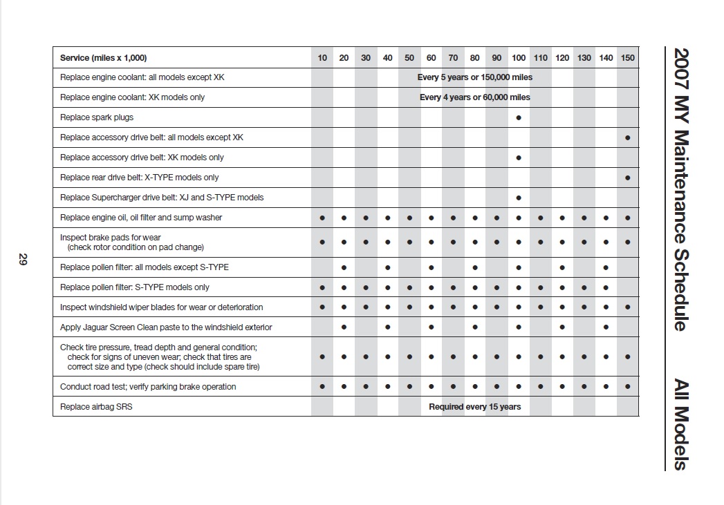

"Normal" is the manufacturer's recommendation and this is every 10K miles OR 12 Months - whichever comes sooner.
Here's the 2007MY Maintenance Schedule:
Low mileage and missed services :(-xk-2007-maintenance-schedule-1.jpg Low mileage and missed services :(-xk-2007-maintenance-schedule-2.jpg
(Click on the images to enlarge them)
Other than oil and filter changes, the two items I'd be concerned about are brake fluid and coolant changes at 2 and 4 year intervals respectively.
I'm never greatly impressed by stamps in a Service Book unless they are backed up with itemised invoices.
You are perhaps being over cautious when the vendor is being lackadaisical. An excellent opportunity to meet somewhere in the middle on price if the vehicle is otherwise impressive!
Low mileage isn't necessarily a virtue or a benefit with a ten year old Jaguar. Regularly used ones are often more reliable than weekend specials.
