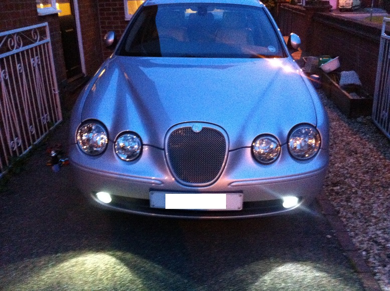

Just wanted to share my experience of DRL lights for my S-Type as I am pretty chuffed with the results…!
We all know how bad ‘aftermarket’ daytime running lights can look and how cheep they can look…. I spent ages looking into finding a decent set and settled on some Apollo Ring DRL’s from Halfords..
Quality OK?!? Not Hella but pretty good for the money. They feel both solid and well made..
Now here’s the magic..!!
I purchased them with the intention of replacing my fog lights, as lets face it, how many people use them unless trying to emulate DRL’s anyway..

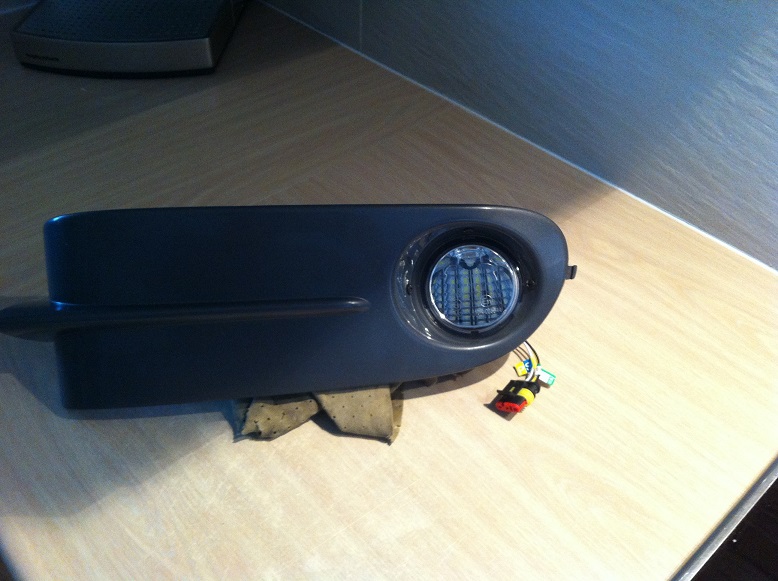

I popped the cover off, remover the fog lights, bit tricky but not too bad, and set about working a fixing method that would give the OE look….
I offered the light to the trim I had removed as it seemed like a good starting point and low and behold ‘click’….! The thing only clips straight into the existing hole with a snug fit and looks like it was made for it…!!!

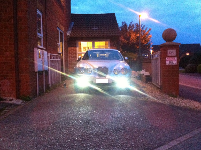

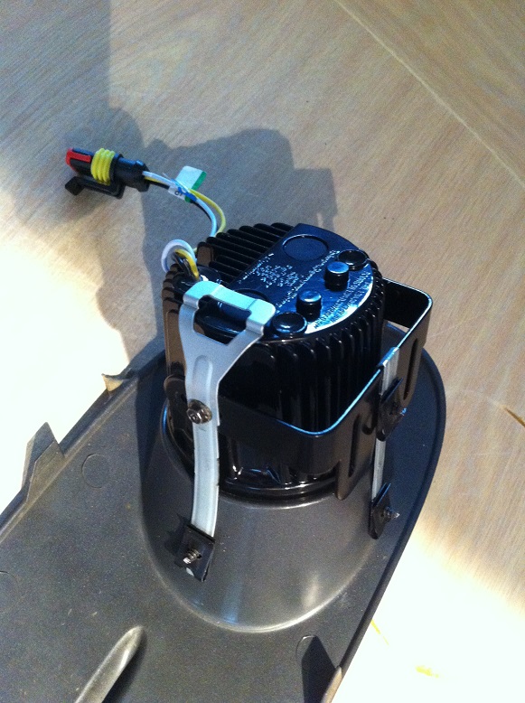

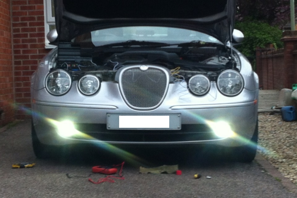

‘OK?’, I hear you say ‘won’t they just drop out..?’, yes they probably would with day to day potholes so I set about fabricating 3 fixing brackets and fixing them to the instillation bracket and side mounts on the lamp… One at 12, one at 3 and one at 9 o’clock, this way it was a permanent fix and would neither fall out or rotate. Simple bit of wiring and plugged them into the loom supplied and WOW!!! They look ace, really bright and look ‘made to measure and OE equipment…. Also dim with sidelights so totally road legal and no error codes on dash..
Personally I think they are a great safety feature on any car…
Check out my pics and if your in the market for DRL’s don’t waste money on LED bulbs for your fogs of cheep looking add-on ones… Go for this set.. WELL WORTH IT and 40mins total to fit..!

Just saw this, what a great job you've done there. Much better than those strip light LEDs that people tend to stick on their cars.
What did you make the straps from, I seem to recognise them as audio system removal tools?

Hiya, yes, radio removal tools..! Had a load lying around as you don't see them much anymore. They were flexible enough to shape to the trim panel and the panel offered suitable support and it all felt very secure so figured it was an ideal use for them! Kind regards Si
