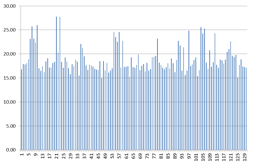

I know it isn't the same, you having a 3.0, but I was pleasantly surprised by my newly purchased 2.5. With a commute of 16 miles of horrendous stop-and-go rush hour traffic twice a day and a few other trips around town it turned in 21.7mpg on the first full tank (calculated by me after filling). This was after changing the oil, oil filter and fuel filter.
Best guess is it is doing an astounding 28+mpg at 55mph.
I'll have new tires (and brake fluid and alignment) on it for a longer highway trip this weekend. I'm really looking forward to it!

On the mileage, mine is a 2.5l, and over the last 28,000 miles I've averaged 18.7MPG with a high of 27.7 (on a long freeway drive of 500 miles), and a low of 14.9. My normal driving is 90% around town of 6-10 miles duration.
The attached chart shows the economy for each of the 130 fills since I got the car 3 years ago.
Regards
Rob
Regards
Rob
