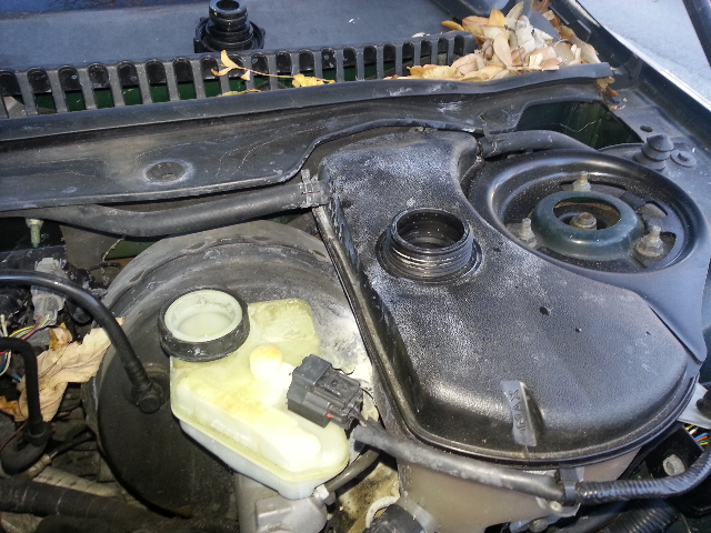

Attached are pics of the coolant that pooled below the expansion tank..
I let the car idle for quite a while..perhaps 50mins. Then turned it off..waited another hour and warmed it up for 5mins nd moved it from parking space on the street..left it alone for another hour nd took it a few blocks to the grocery store and back..all the while checking below the car for any leaks..
I'm happy to report that I did not see any leaks like the night before and it also didn't overheat while I took it around..
I don't want to get too optimistic since I just drove it a few blocks..but I did not get any leaks or overheating warning on the temp gauge..
Isolated incident??
