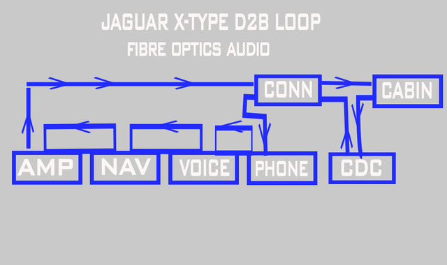

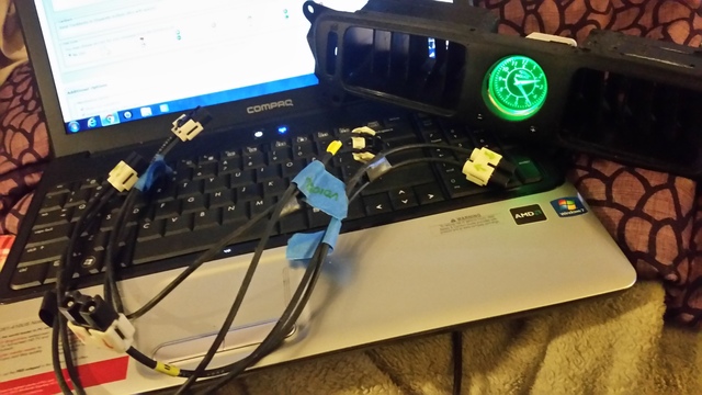

very rare for them to go bad ,if you open it up you have two spings either side ,may be some connection not right or pulled out ,its in a loop if you break the loop nothing works, also check behind the radio

tinted the windows on the car and when I was done the radio still powered up, but no audio output. was thinking it would be easier / cheaper to connect in a new fiber cable outside the car without running it through it to check and see if it is the issue. rather then purchasing a used amplifier and finding out it was the cable.
