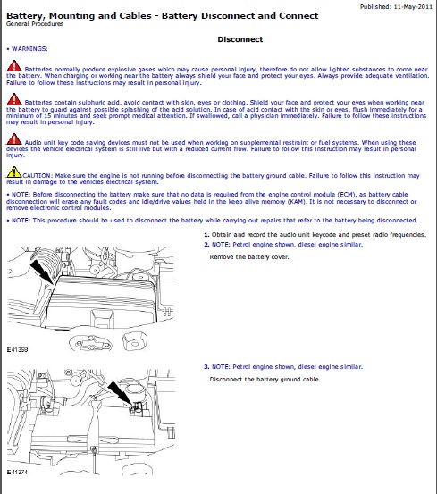

Old Jan 19, 2014 | 01:37 PM
Originally Posted by ChelseaFC2014
...... Could you give me detailed instructions on how to disconnect the battery? I have never done it before.
Here's the relevant section from the Workshop Manual:
Note the mention of 'audio unit keycode'. It is very unusual to have a coded radio outside the UK but there have been a very small number reported in the US and Canada.
In the unlikely event you do have a coded radio, there should be a card in the vehicle document set with the four digit code.
