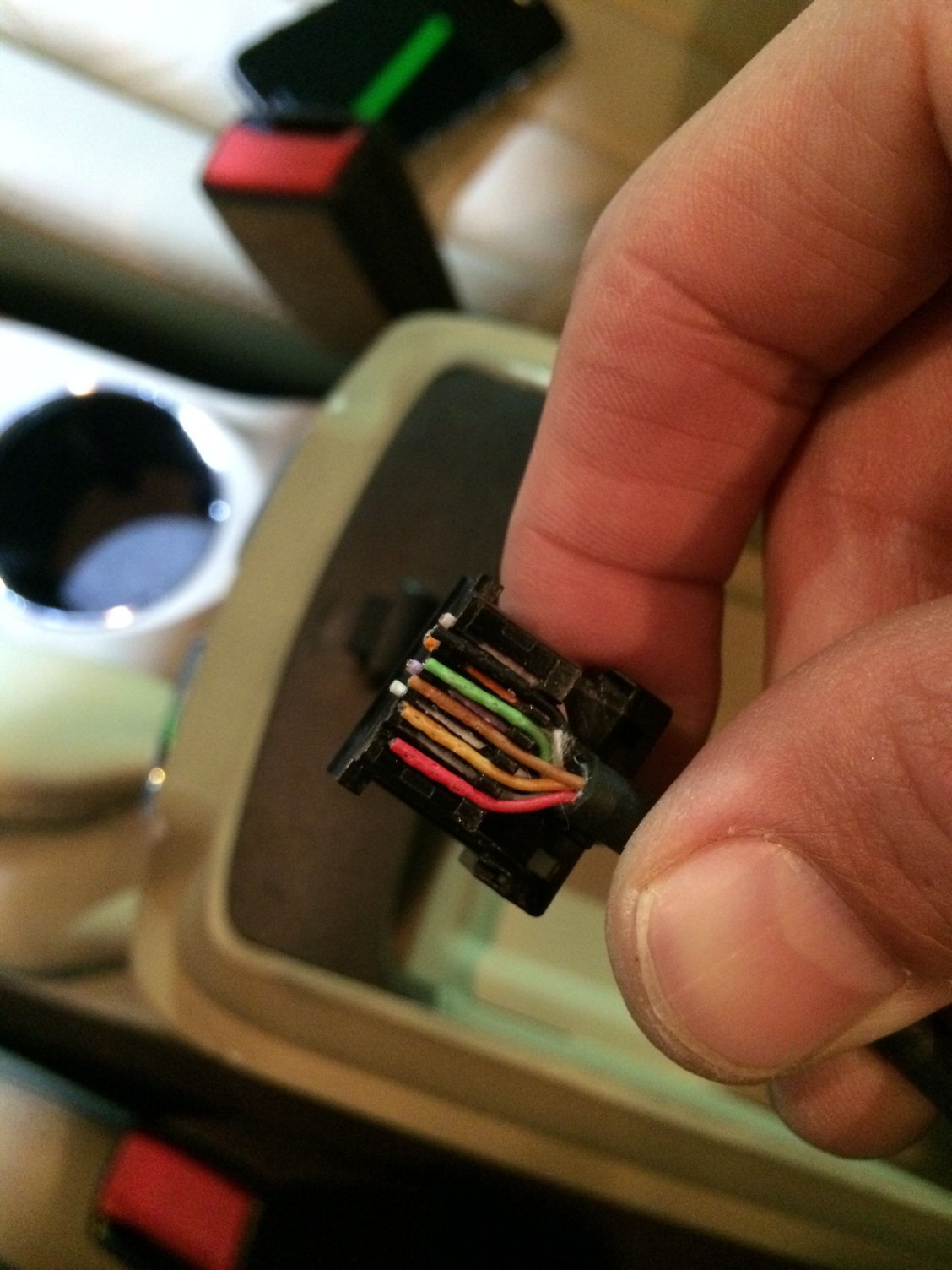

I'm asking you kindly to help me with this issue:
- I asked a guy from service to change my armrest with a new one. In order to take out the old armrest, he opened the phone jack and took out those 10 wires from their place without making a picture before...and now I don't know the colour order of them.
- I managed to find the power wire and if I press the power button from my phone I see on the nav display that it's starting and shutting down...but no signal, no display on phone, etc.
Could you please give an advice/a phone wire diagram/a picture with an working opened phone jack in order to see the colour order for all the 10 wires?
Thank you much!!

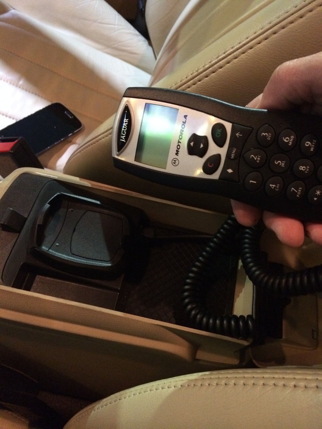

Excuse me. My car is an x type, 2003, 2.5, 4x4, automatic, with an oem motorola phone in my restarm.

You need to go to the following website and download the electrical manual for the 2003 x-type. It has the complete wiring diagram you need.

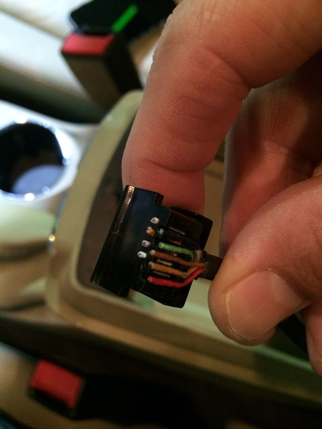

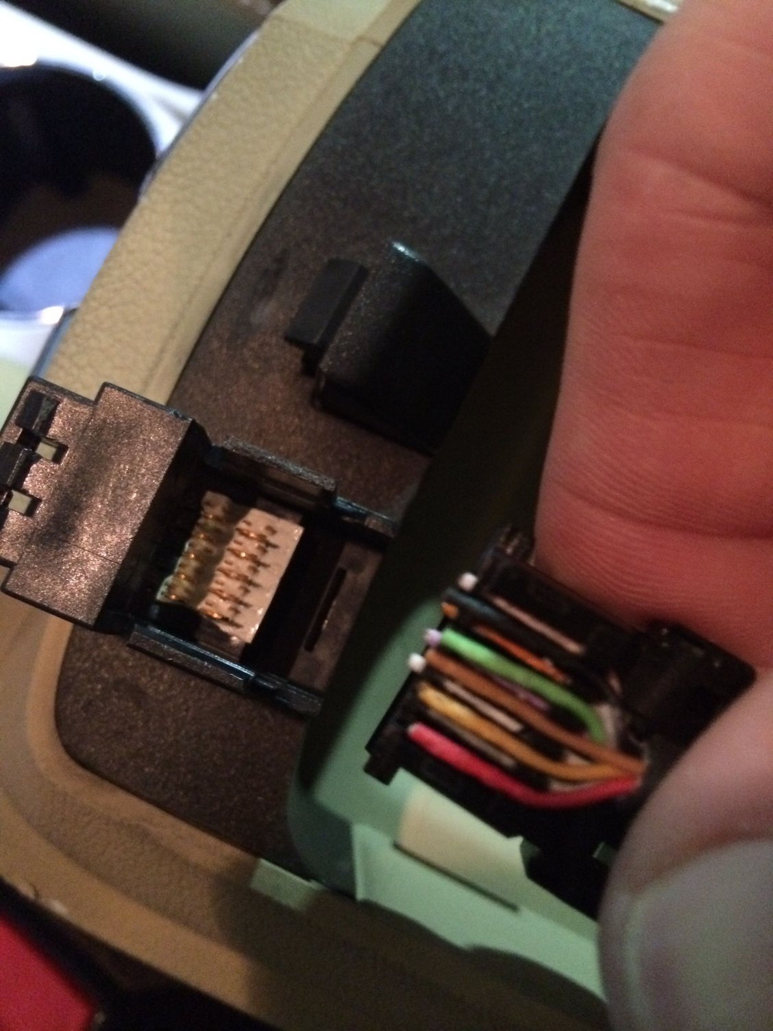

As you recomended I downloaded the X type full diagram and checked a solution for my problem. I couldn't resolve unfortunately....the codes in diagram are with base colour and stripe and I have wires only with full colour. I do not understand...
I attached some pictures with "the problem" and I hope that someone will give me a solution.
In this moment I think that the only solution is a picture from somebody with a working phone jack in order to "copy it".
Thank you much in advance!!!

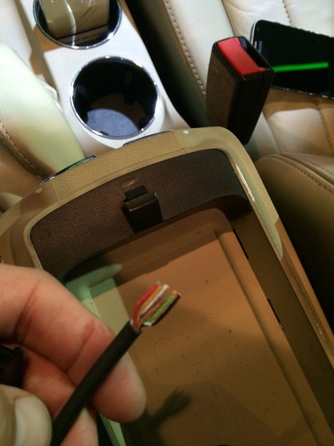

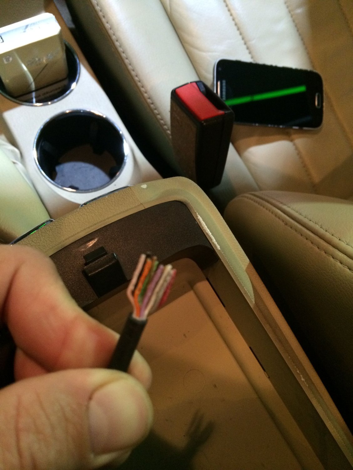

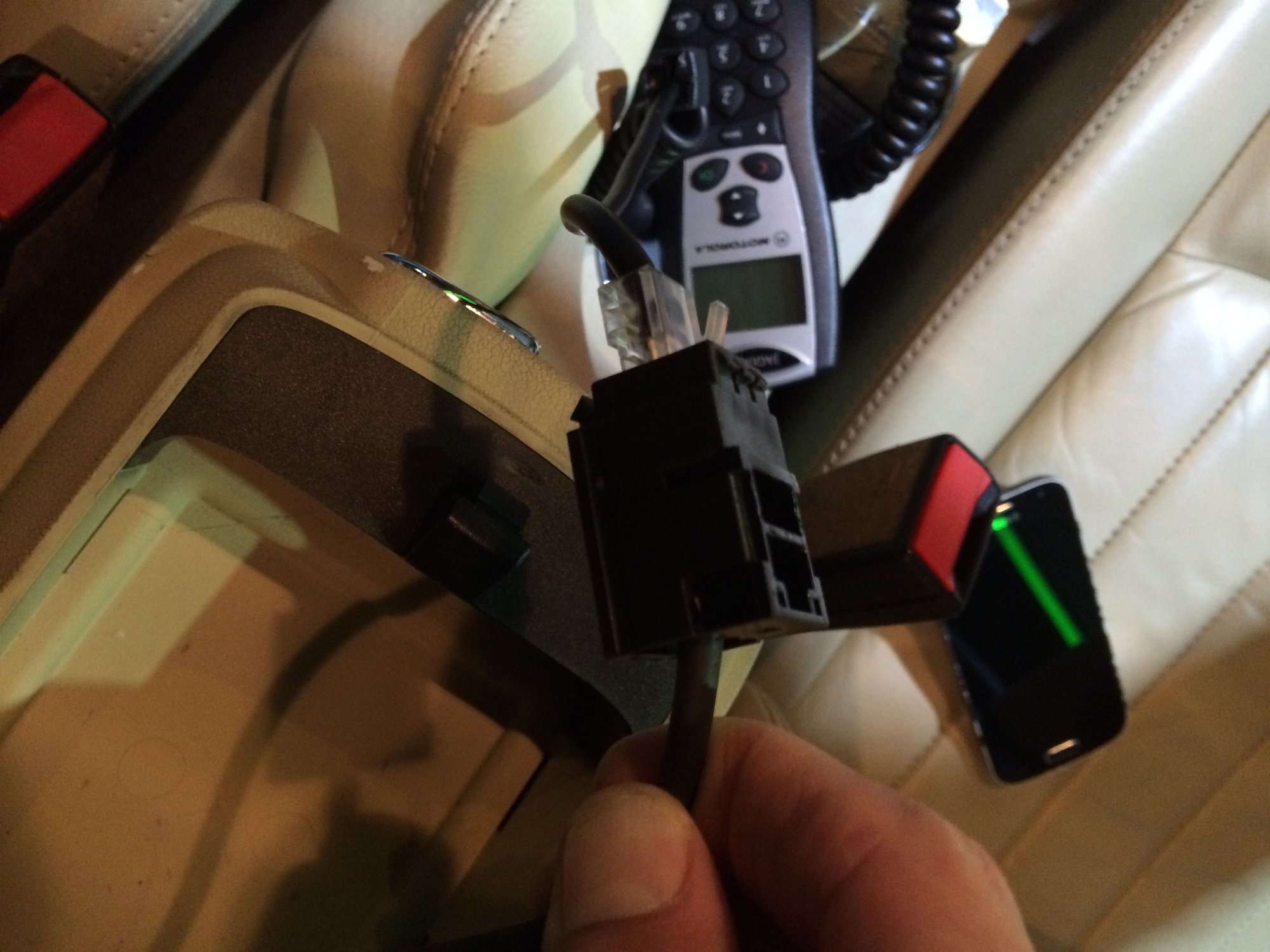

This is the phone cable with 10 wires that comes from the center console in my armrest.
This is the jack with 10 little holes where the wires get in

Probably if you pull back another inch of the insulation you will probably find the tracers, but that is not important. The diagram shows that each of the wires is connected to the same color except the last two. you need to get access to the other side and match out the wires.
