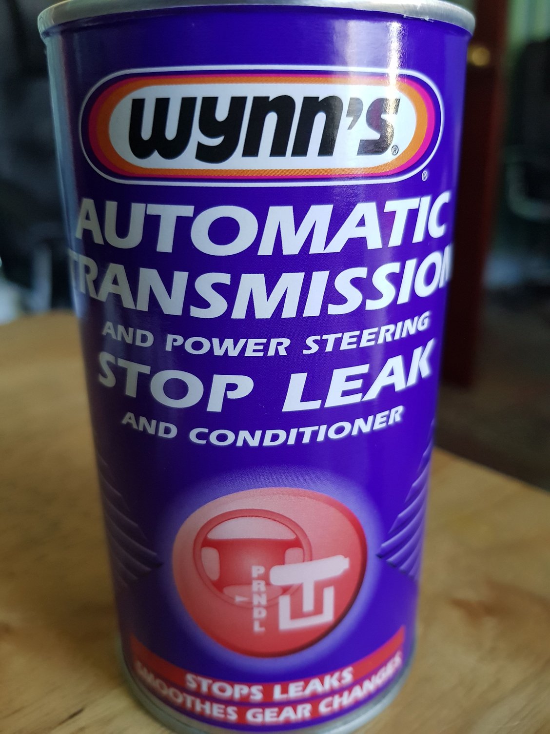

I have got this. The person had halfords said to put in the filler with the engine oil cap.. Is this right?

The ATF is inside the transmission, lol. If you're looking for a "dipstick" or a place to add/fill, there is not one as such. The JATCO transmissions in X type are "sealed for life" (peed myself a little bit on that once again).There is an original fill pipe (factory fill) just to the left (when facing car with hood up) of the battery box on top of transmission with a rubber "bung" capping the pipe.
If you're contemplating a change (as I will be doing next weekend), do a thorough forum search on various procedures/ideas/correct fluid types(s).

I am not sure what kind of problem you are experiencing but I don't have any confidence in additives as a cure. If you are trying to stop a leak it would be better to let us know where it is leaking and we can advise you on the the best course of repair.
If performance is a problem you might want to give us a little more detail. In the end it is your vehicle and your decision but if it were mine I wouldn't consider using any additive.

Do NOT put stop leak in the JATCO box. It will clog the solenoids!
You'll be sorry if you put that product in your transmission. You're getting false advice to put in engine sump.
