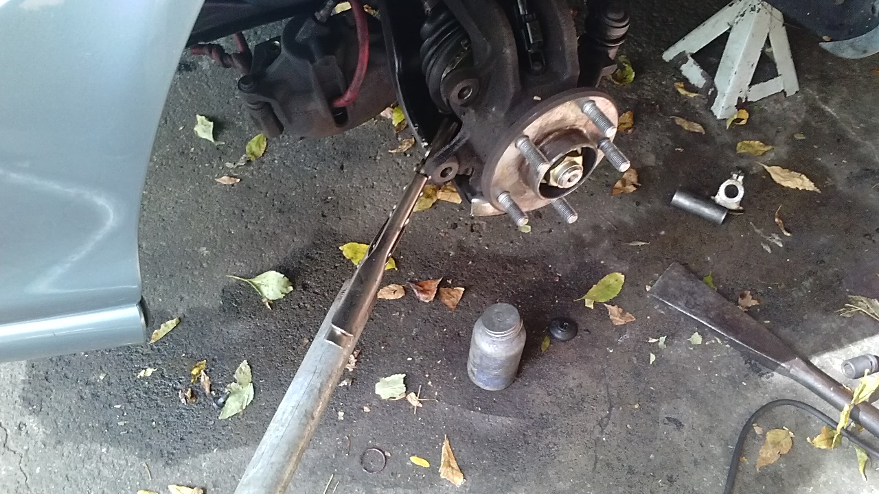

Many people on this forum have been lamenting how difficult it is to get the lower ball joint out of the knuckle.
All you need is a large vice grip or crescent wrench. Clamp it on to the lower control arm. Put a pipe on the wrench handle for leverage and problem solved!! This will save you hours of aggravation!!!
See photo
